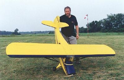

All Day Dan's Avatar
Joined: Dec 2002
Posts: 4,606
From: MANHATTAN BEACH, CA
Whippy, I have a semi-scale Champ that has a wing span of 97 inches a wing area of 1200 square inches and it weighs 21 pounds. it is over powered with a 40cc engine. Dan.

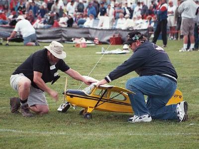

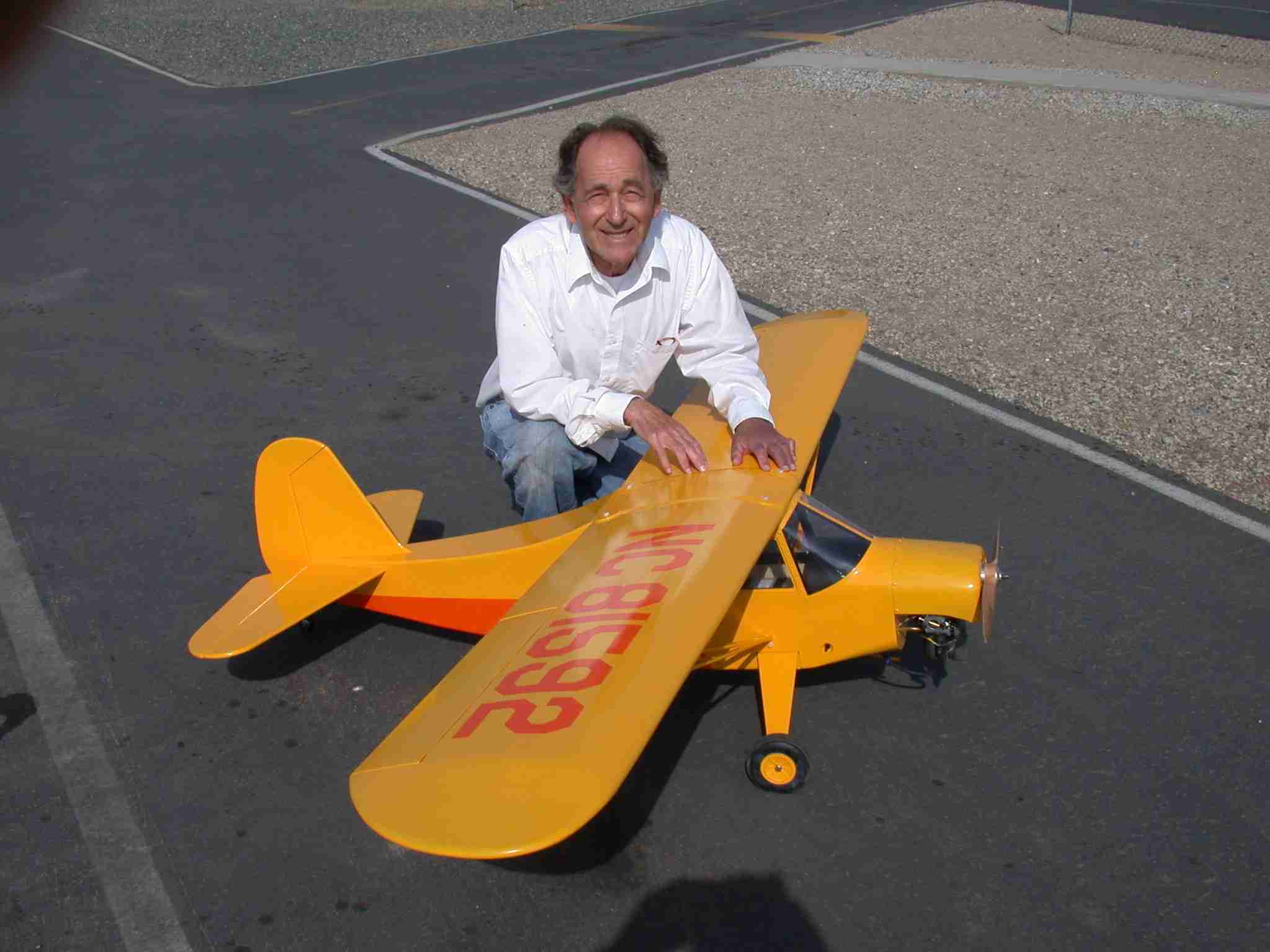

Propworn's Avatar
Posts: 2,489
Received 32 Likes on 26 Posts
From: Canada
1/4 scale Champ Bud Nosen used a Quadra 42 the weight balanced it out perfectly and I flew it scale at 1/3 to 1/2 throttle. Its very nice to have a little extra motor when you need it to get you out of trouble. If your flying at the smaller engines limit and you need that extra power to pull you out of trouble you may be out of luck. Throttle management is everything. You will have to end up adding lots of weight with the smaller motor why not make it usable weight by installing a bigger motor.
