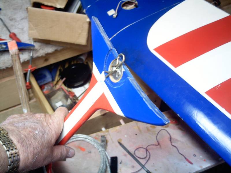

Here are some pictures of how I am doing it. Note that I have hedged my bet with a hich pin on the top of the strut. I have ordered the more powerful magnets but I don't have them yet. I don't think the RS magnets will do it. The pictures show there are washers there to attract the magnets

Oops one wrong picture

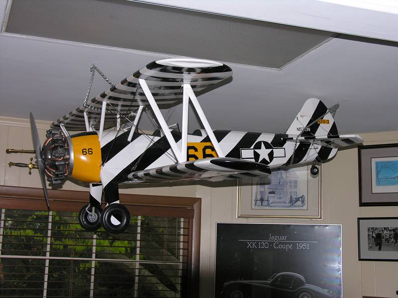

Yeah. Field setup is why this hanging in my office and will continue to do so. 77" w/span, 15lbs, 4 wing panels and more than 50 bolts, nuts, clevises and screws to get the wings on and off....
Once I got it all together, all flying and landing wires adjusted, I llet it sit for a few days and then hung it up!
I enjoy looking at it, tho. LOL

mobyAl, love your paint job!
Old 08-19-2007 | 11:57 PM
Joined: Jan 2006
Posts: 1,556
From: Lexington, VA
Default RE: Bipe assenbly
TY
It's authentic -- the "Recall" scheme.
