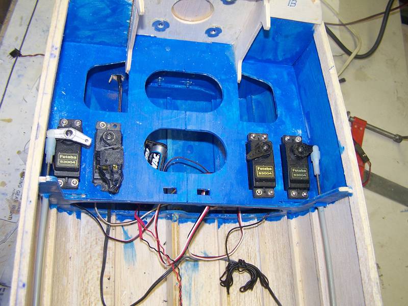

well I got the lower half ofthe fuse completed. known I'm waiting for the motor that ordered to come in later this month. I decieded to get a Super Tiger. (on a buget[sm=drowning.gif]) some day I'll post photos

I completed the lower half of the fuse. I have placed all four servos in and the switch for the landing lights. I am thing about making another hatch like I have done on my first Cessna. Opening the luggage hatch and placing all the switches and charge jacks a

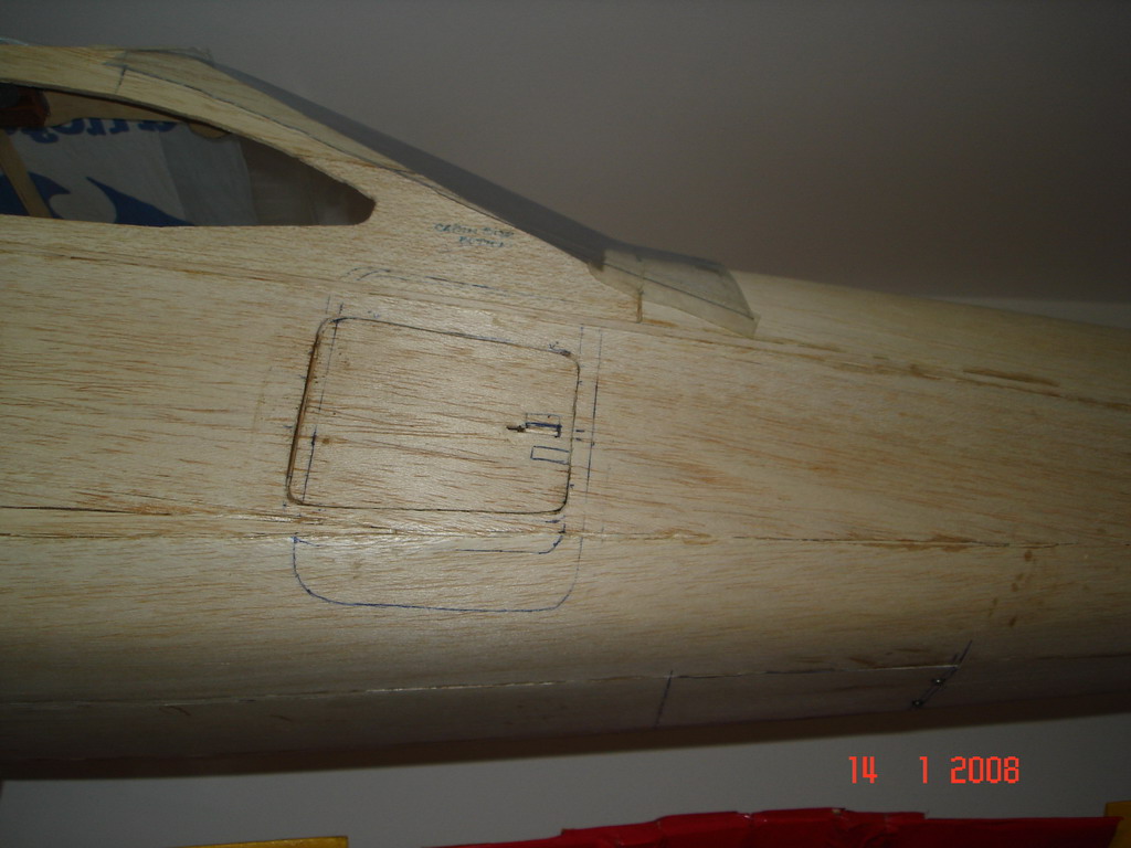

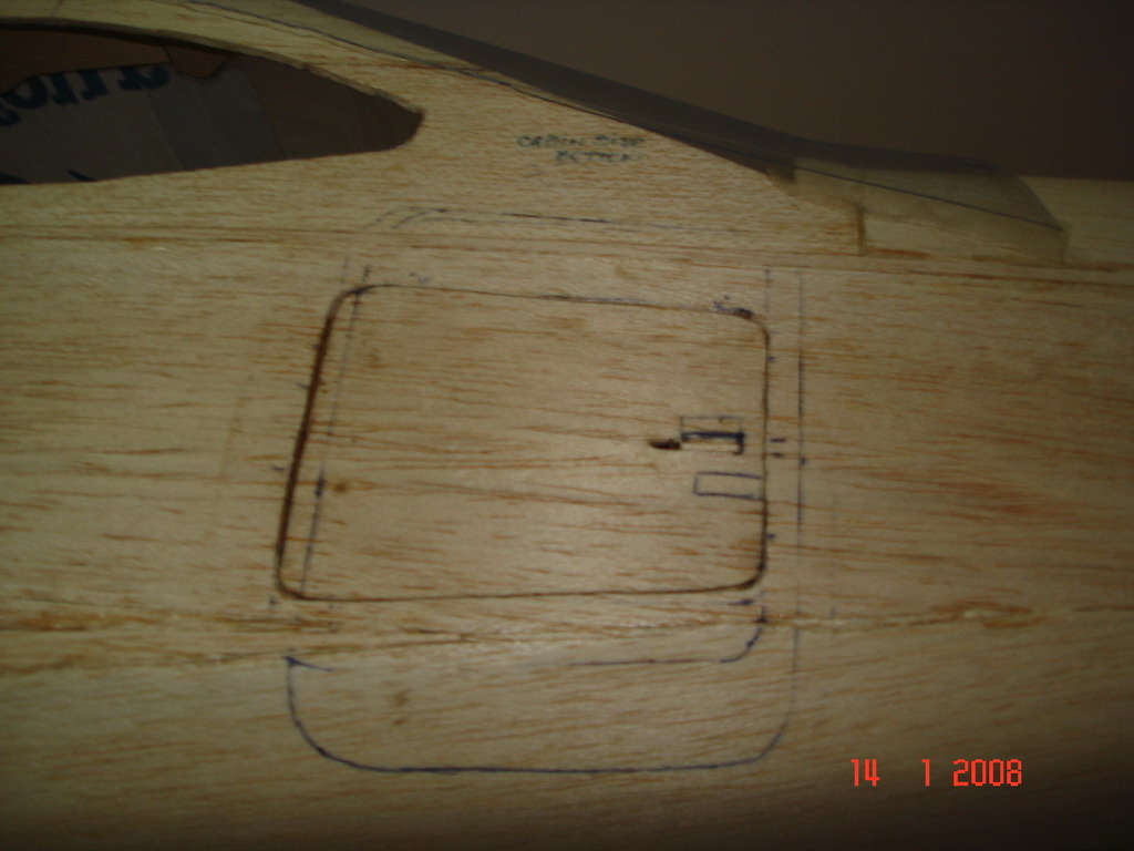

that looks good "chutt" what did you use for the latches and henges?? because I'm still thanking of making the luggage hatch serve as the accese panel.

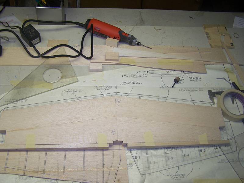

[img][/img][ul][*][*][*] [/ul]Today I finished the stab. and both elev. I tryed something that i read on RCU. I took the TE of the stab. and the LE of the elev. and placed then on the plan as diricted. I then per drilled the holes henges aftre i placed all the ribs i then plased bass wood behind each hole then redrilled the holes and tested the fit. after I completed sheeting I replaced the hinges not glueing them. I did work out and kept everthing in line. I did make a mastake that cause me a great look but live and learn
Thank you fcf...
I made a luggage hatch to hide the switchs, recharge jacks...
Cheers,
Andre.

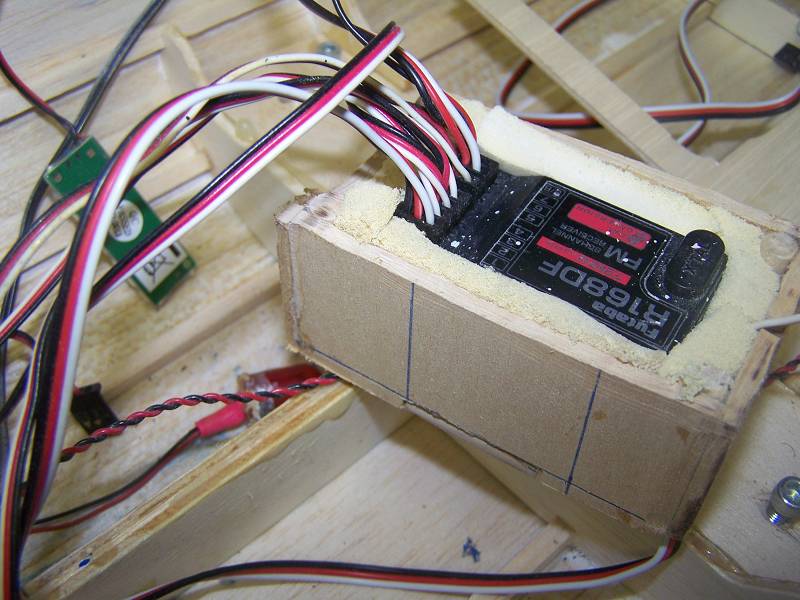

I slowed down a little. I got the stab, rudder, fin and elevators build. last night i made a safe box for the reciever
