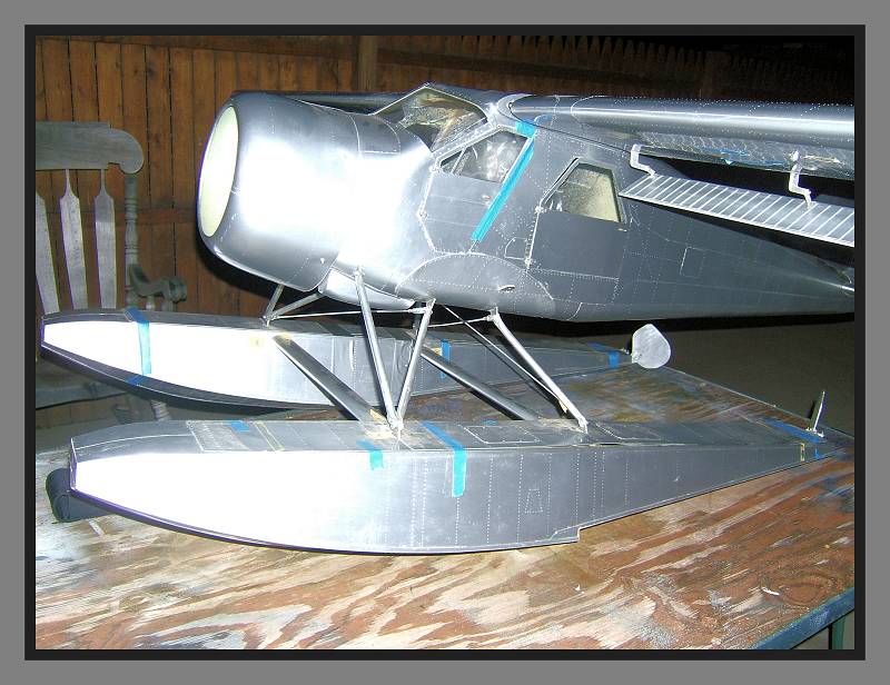

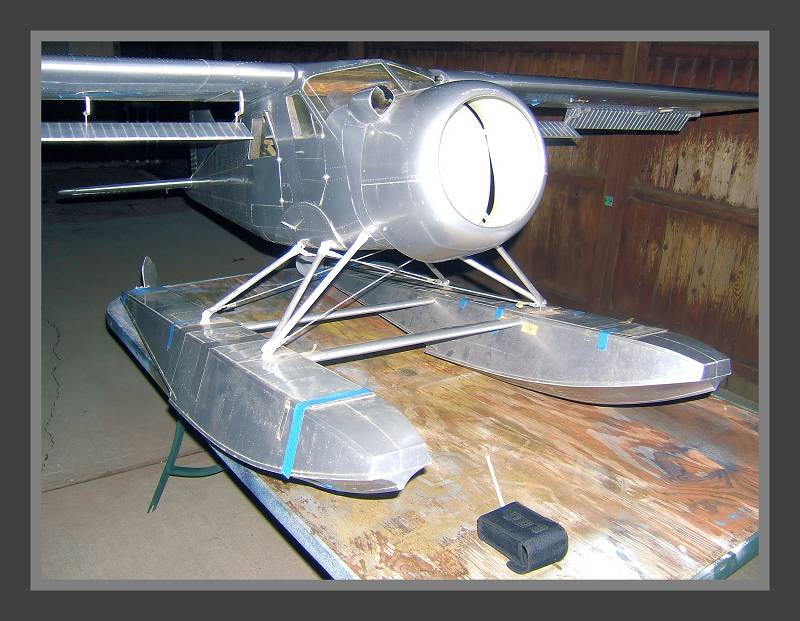

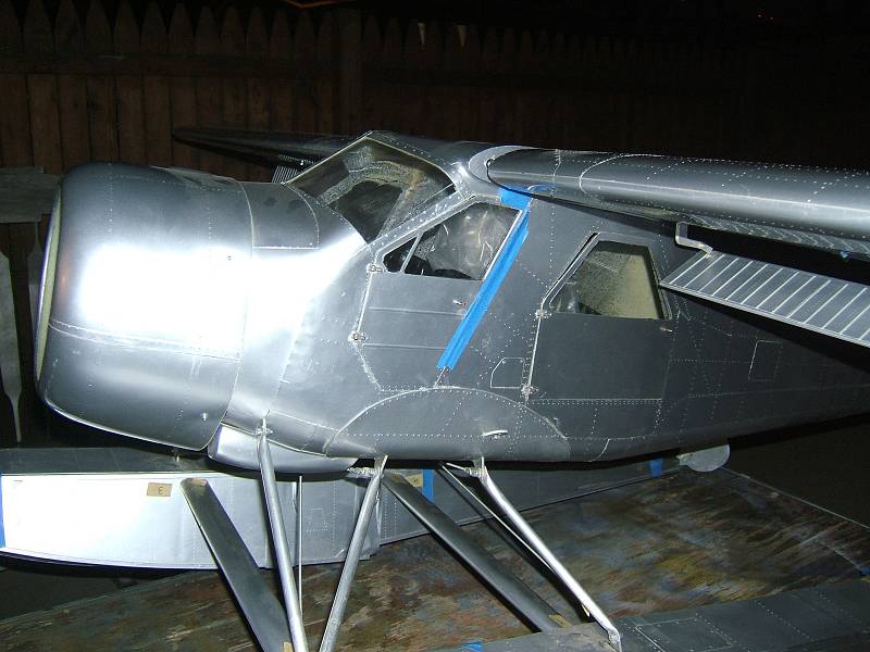

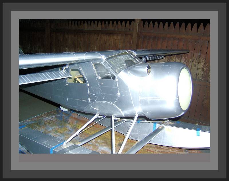

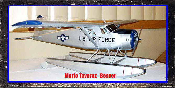

any body know who make this kit , is the beaver , and is full scale , full composite , i have this kit for long time but i lose all instruction,
this is the beaver before and after , but i need the cg please reply att mario

Mario,
A rough guess would be right about where the strut hits the wing.
Or measure back from the LE aprox. 20-25%.
RD

Mario,
'Just saw a post on another thread. 30% of chord from LE should be CG.
