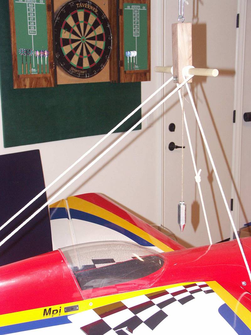

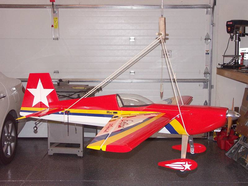

ORIGINAL: Rfabbre
I agree with gboulton. Go with the Vanessa. It works great and you can make changes "on the fly" (while the plane is suspended) by moving batteries around.
The thing sounds complex when you first read about it but it's very easy to built, even easier to use. And, no math ,...ever. I tweak my giant scale every few weeks just to see the effect on flying.
PS-be sure you use a small level so you have the plane horizontal (level).
Here are a couple of pics of one of my planes suspended on the Vanessa. You can't see it, but I put a small mark on the fuselege where the GC is susposed to be. When the plane is level, the plumb bob points to the GC. Just move around some weight (probably batteries) to get the plumb bob pointing at your mark.

Here's another shot of one on a Vanessa:
Note at the wingtips the piece of string held on with tape. That "drew" a CG line all the way across the wing, as a point for me to aim for.
FWIW, the Vanessa cost me roughly $10 to build...and the rope was a majority of that. *heh* They do, indeed, seem a little "confusing" at first, but once you get the idea, they're really pretty simple.
