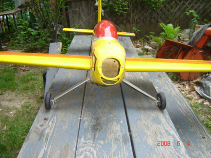

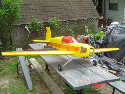

I bought this plane at a swap meet last year. The guy i got it from said it was a 300 but i dont know 300 what or who made it? it has a 85" wing span made of balsa and foam. It takes a G38 or equivelent. can anyone identify the make of it??

The model is a PC 300, from Air Flair. http://www.airflair.com/
I flew mine with a Saito 300 twin. A g-38 may be a little small, but if you have one, give it a try.

Looking at the pics again, your model may have been mine at one time. The color scheme is similar. Look below the canopy. I had my name on the fuselage side.

Hi Tom, Yes it says tom crump on the side of the fuse. What kind of plane is it and what company designed or kitted it? How did it fly for you? I have'nt done anything with it yet i just got a 42cc 2.5 poulan chain saw engine i'm converting for it. would this be conserder a 30% or what? Just out of couristy where are you from? Also what would be the smallest enging that would fly this plane?

Sorry i just got your other post with the make and engine info, Thanks again...

Follow the link above to the manufacturer.
The model is part of a series of good flying, quick build giant scale aircraft. It's a sport model, so no scale percentage is applicable.
Give your Poulan a shot. It should be fine. My big Saito gave it nearly unlimited verticle, but I usually flew at 1/2 throttle.

Hi Tom, hope you don't mind if i ask a question or two about the plane. did you cover this plane oand if so what kind of covering is on it? is's comming loose in places and i thought i might re glue it without recovering the whole plane. Was this a arf or what when you got it?

I built the PC 300 from the kit in the above posted link.
I seem to remember covering it in 21st Century fabric. The yellow should be Cub Yellow.
If the covering is coming loose, use some BalsaRite and stick it back down using a low heat setting on your iron.
A friend of mine, more knowledgeable than me, says that your 42cc Poulan should pull the airframe well. Remember, the PC 300 is more of a precision aerobatics trainer, and not a 3D machine.
I liked the way it flys. Landings may be the trickiest part. The model slows down well, remaining very stable, but it will give you no warning as to when it doesn't have enough air speed to fly. Keep your speed up, flying it to the ground.
