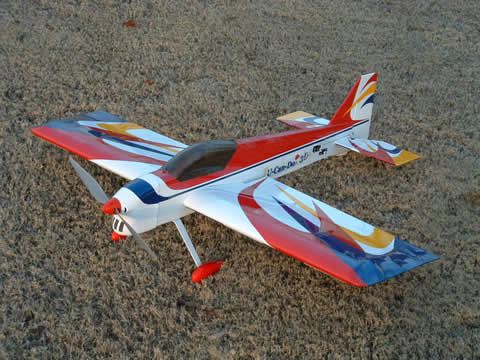

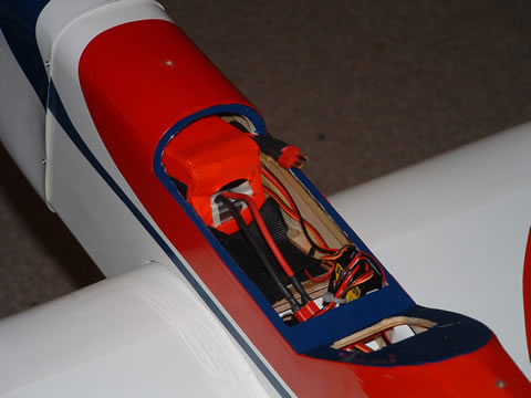

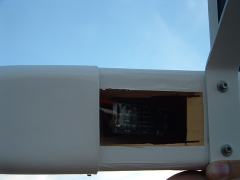

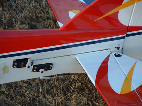

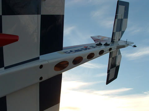

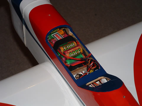

I dont know what it is about the Great Planes UCD .46 and 60, But I have always favored them. I like the way they look and I like what I have seen of them in flight. I made a decision to sell the Funtana and purchase a .46 for conversion. The FuntanaS was fun, but it was time for a change. With Lipo's it comes in just under 6 pounds.
Mega 22/30/2
Superbox 4.28
17X10
14- HR-SC 2600 & 4S4P 8ah ThunderPower
CC P-60
UBEC
5- HS 225 MG.
Hitech Supreme 8ch RX.
49a WOT and hot off the charger.

I have had 10 flights on this plane so far it is a blast. I pushed the prop up to an 18X10 while I am using the 14 cell 3300's and 4S4P 8ah TP pack. I have some new 10C 5S4P 7600's that I need to try out and will change the gearing to a 4.6 and swing the 17X10. Hover is just above half, flat spins are nice, but need the CG moved back and the stall just mushes to the nose. A very fun plane indeed.

Mike,
It looks like you have a great e-conversion in the UCD. Nice job!
I didn't see any all-up weight posted. Did you measure the weight?

Thanks Greg. It weighed in at 6 pounds RTF. I have switched from a 4S4P to a 5S4P (extra cells added a few ounces) and a deeper gearing. Thrust measurements are right at 2:1 now. I hope to have some more video in the next week or so that will show the performance of this setup. Now I just have to watch the motor for heat.

Just curious, how many watts to the prop is the setup yur using?
If i were to use a AXI 4120-14 with 16 cells which is about 700 watts..Would this be good to hover my UCD?

Per Motocalc, I am getting about 900 watts/lb on the 5S. On the 4S I was getting about 800 w/lb and it would hover and pull out at a decent clip.
I really prefer a geared solution for a 3D plane as you can get more prop for less amps. A 14" prop is about the limits on the 4120 and the amps start getting towards thermal above that. You could in all feasability gear the AXI in a belt drive or MEC superbox (same one I used) and double your output. If I already had the AXI I would gear it in the superbox at 1.5:1 swinging an 18X10. Weight should sit around 84 oz and thrust values should be around 135- 140 and 800 w/lb.
