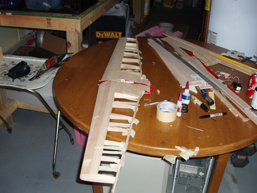

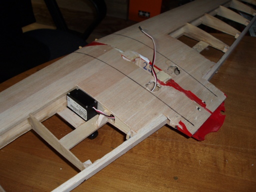

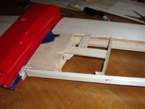

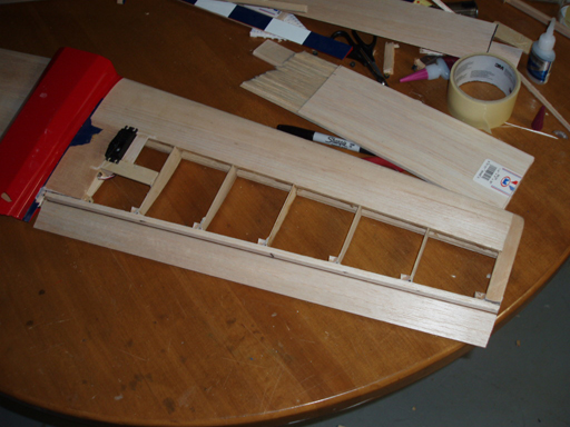

Old 05-19-2006 | 06:05 PM
  #89
Joined: Feb 2005
Posts: 3
From: Cleveland, OH
Default RE: Modeltech .25 Extra 300 conversion
Whats that saying? If it aint broke, brake it... Well, I too have had a Modeltech Extra conversion for some time now, and it flies great. So, now that it is trimmed, balanced, and flying beautifully, the only next logical step is...change it.
I love the performance of the plane, but I couldnt help but think, "Why are those ailerons so tiny?" And thus it began...
View the following pictures at your own risk, as I have no idea what the end results will be...but it might not be pretty...
