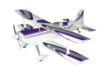

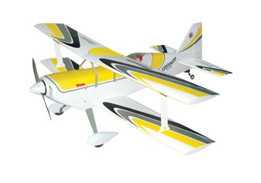

How about the Ultimate 40S from [link=http://www.airborne-models.com/html/productdetails.asp?ProductID=84]World Models[/link]?
I'm doing the yellow one.

To have a great power level and performance, I plan to use the following setup.
[ul][*] [link=http://www.hobby-lobby.com/brushless-axi4130.htm]AXI 4130/16 motor[/link][*] [link=http://www.hobby-lobby.com/jetiblue.htm]Jeti 77-amp Opto ESC[/link][*] [link=http://www.hobby-lobby.com/elecprop.htm]APC 15x8 e-prop[/link][*] 6s Lithium pack that can deliver 60amps continuous like two 3-cell [link=http://www.fmadirect.com/Detail.htm?item=2077&section=45]Cellpro[/link] packs in series[*] [link=http://www.hobby-lobby.com/ubec.htm]6v UBEC[/link] to replace the Rx. battery
