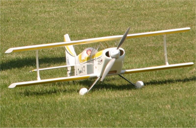

Finally, a successful maiden with the AXI 4120 motor. The Ultimate flew great and I hope to get a video today at a local electric event in the Finger Lakes of NY.
#133
My new power level is 1100w/5.5lbs (or 200w/lb) using the AXI 4120/16 with a 6s Lithium pack. I can't remember what the weight was so I'll have to scan the previous posts.

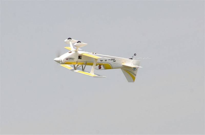

We got some video yesterday showing the Ultimate in some pretty brisk 10-15mph wind. I'll post it later this week. It had plenty of power and didn't really affect the flight. The combination smaller prop on a 6s Lithium pack really makes it nice and fast!
In the end, I feel that I am better off with a maintenance-free direct drive brushless motor.

Although the stock foam wheels worked ok on my first flights, they seemed a bit small and soft for the job. After sitting in my trailer for days, the foam would retain a flat spot that made for an uneven roll.
I decided to replace the stock wheels with bigger 2-1/2" Dubro Treaded Lightweight Wheels (250TL). The 5/32" (4mm) axle diameter was perfect for the stock hardware and I only needed to round the outer ends of the pant opening. The firmer rubber wheel should provide for better ground handling.

Although it was rather windy, my Ultimate 40S still tore up the sky!
[link=http://www.gregcovey.com/reviews/Ultimate40Selectric.wmv]Ultimate 40S Video[/link] (7meg)
