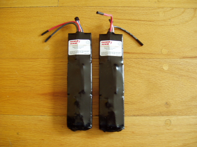

Hi Guys,
The kit is in it’s way , I have been reading mookie’s post of his P38. I’m planning to have almost same setup.
Axi motors 4130 -16
props 15x10 or 14x12 or 16x??? (taking off from asphalt)
Castle creations Phoenix 60 or 80 (please recommend)
Robart 550 mains
Robart 560 nose
This is my question before starting the P38. I now I need a lipo pack with 6s for the right RPM now.....what would be better option.
3s4p x 2 packs serial / motor (that’s mookie’s setup) Heavy setup
3s3p x 2 packs serial / motor lighter
3s2p x 2 packs serial / motor +lighter
6s2P x 1 packs / motor (long pack??? would it fit?) +lighter (same as above)
6s2P x 2 packs parallel / motor (long pack ??? would it fit?) Heavy setup
I’m worry that the long packs won’t fit. And, I’m flying at 8000ft so maybe it would be wise to reduce the weight using less parallel cells. Only you can tell me because you have used many different packs. I’ll make pics of all the building process

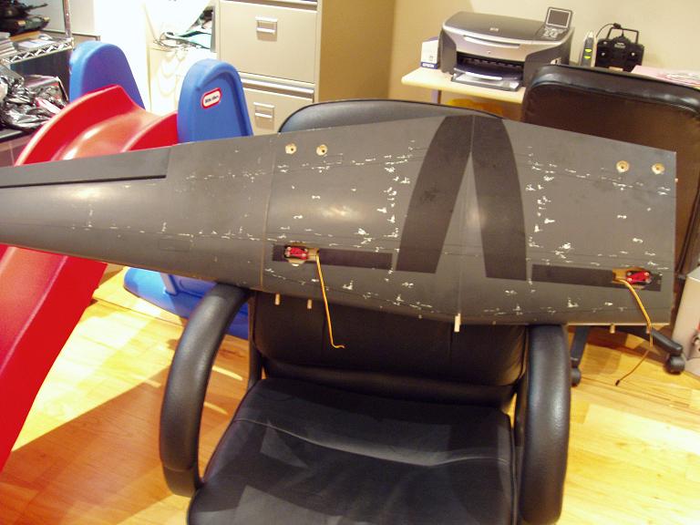

Hi
The flaps is the item of the day. I´m using regular aileron servos for flaps on the P38. After I did that they work almost perfect but I think that they are a bit sloppy, This is not to good but I don´t know how much would this affect the performance of the model. I would like to know if Mookie´s bird is the same and if he could adjust this problem or maybe it is acceptable to have them like this?
Here you have photos, look at the great detail of the wings. I keep thinking if I´m going to be able to see the airplane in the air (the bottom is sky color). LOL
See you

Hi Again,
Mookie you are wright I don´t need more stress (I have that flying jets), I´m going to use aluminum tape for making markers on the bottom. And here are for all the people reading your answers to my questions:
"My front strut was a problem. I had to use all the room in the nose gear compartment to make it work. You need a little bit of an angle to get off the ground. My first flight went fast but not in the air!
My flaps were sloppy too. It's OK just make sure they move the same distance. "
So we are going to continue ASAP. Tonight I installed the aileron servos and it was easy. The difficult part was to take the cables inside the wing.

TX
On this plane I'd consider using 2 receivers and treating it like 2 planes. One receiver in each fuse. Save lots on intercoinnecting wiring and make it simpler to put together at the field.
Set the controllers for the advance they recommend for AXI's I think it is 'hard advance'. Set them to soft cutoff so the motor pulsates if the battery voltage gets too low but does not stop all together. Set the current limiting to insensitive or disabled if possible. We're just trying to eliminate the possibility of one motor stopping.
On props, at your altitude I'd guess 16X10 or 17X10 APCE. Try the 16 first. Prop for about 45A but don't use WOT for more than 30sec or so at a time. If you do and hear a whine from the plane, it means one motor is about to fail so throttle back and dead stick it in. Don't ask how I know.
Good luck. This is one I want to do.
Oh for batteries, I'd buy 2-6S 3,650 Tanic packs from Brian at Tanicpacks.com They will be very happy at 45A.
Keep your battery wires short as possible.
Don't forget a UBEC or 2 for flightpower. They make 4.8V and 6V

hi.
I'm going to use 2x 3s4p packs for each motor. I'm only going to take off only the outer parts of the wing the rest will stay together. So no complication taking it apart. I'll use one RX with a Y connection for the 2 ESC's . It's a very good idea to take the power cut off out for this model. The props... I'm afraid there is no space for biker than 15x10 or maybe cutting a 16x12 to get more pitch. I'm going to buy a bat signal that sounds a set of tones when you connect the battery for # of cells and charge amount, this way I'll prevent the risk of deep discharge of the Lipos. I'll post pictures soon.
Leon G

Just to save a little weight and also to be able to use the packs in other airplanes I'm going to use 2 3s3p packs per motor. And we could tell that is more like 20 cells. I'm using 15c rating cells but the total draw would be around 45 amps per motor so no problem. I'm going to be in FLA for 10 days so I'll have to post when I get home more information. I need this airplane to be ready in 3 or 4 weeks tops so you will see even the maiden video by that time.
Take care.

Glacier, The packs are 3s3p (4 of them) they will be 2 on each side of the plane and connect in serial to form 6S3P per side.

Glacier, I'm using 2 pack 3s3p per side of the plane. This two packs are going to be connected in serial making 6s3p.
