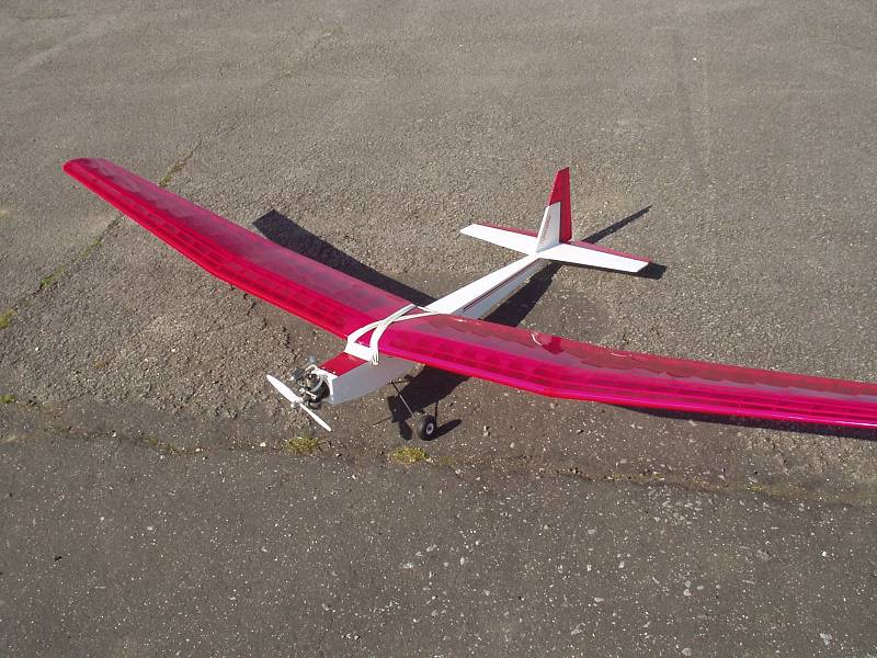

thought I would upload photo of "my" butterfly.
I say "my" as I never built it - bought it complete ready to fly at a model bring and buy - only had to put crystal in Rx, charge and test batteryand fuel her.
Engine is an old OS15 - underpowered, but on nice low wind days - ok to get up into thermal territory where the butterfly struts its stuff
john
ps , the lump below the engine is lead to get cg right. nose is short and would suit lengthening for electric and battery aand getting cg ok
