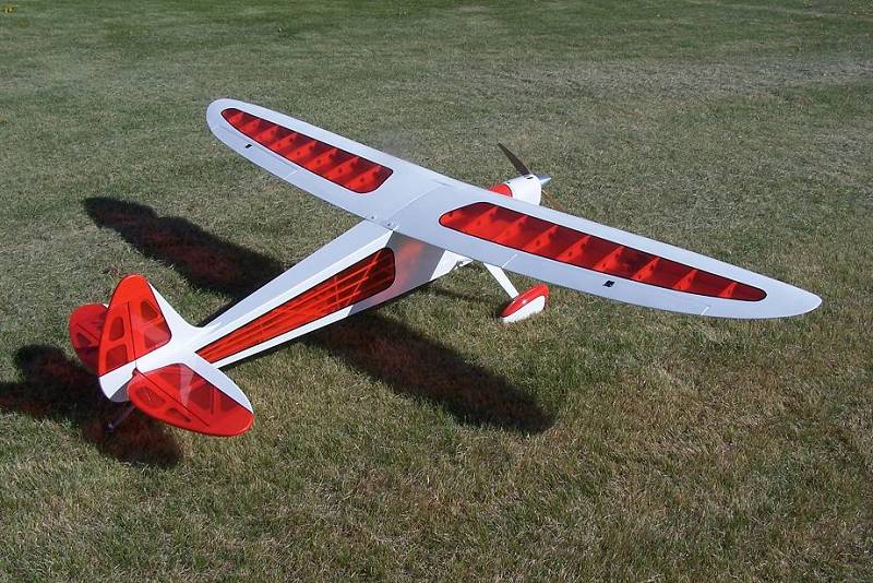

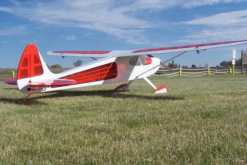

Hi Folks,
I have always loved the looks of this airplane and thought it would make a great conversion project so here's my version. I just wanted something to cruise around with, do touch and go's, and just relax and watch it pass overhead on a calm evening. It doesn't "rocket out of a hover" or have "unlimited vertical" but at 120 Watts/pound does nice big loops and has decent vertical for hammerheads, etc.
I know I'm not the first to convert one of these and would enjoy seeing what others have done with their Rascals. Thanks to Chet Tuthill for sending me pictures of his along with some good ideas. I noticed Mike Worthen put a Hacker A60 and ten cells in his so it should be ballistic compared to mine.
I always learn a lot from you guys and enjoy seeing your projects in this forum.
Thanks for letting me share.
Bob
Rascal 110 specs and equipment:
Weight: 13 pounds
Motor/ESC: E-Flite Power 110/Jeti Opto 77
Battery: 2 Flight Power Evo20 4S1P 5000 (in series)
BEC: Kool Flight 6V
Watts (static) With APC 19X8: 1570
Amps: 55.4
Watts/pound: 120
Radio: Spektrum DX-7
I forgot to add that I put the second and third flights on it this weekend and could not be happier.
