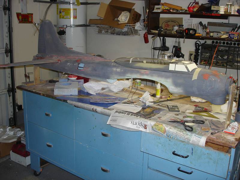

As far as my B17 goes .... it proceeds slowly because I am leaning. And I must think thru each step which is very time consuming at my age. Details make the foam modeling process slightly different from that used for man-carrying airplanes. Whether or not I can use foam for this model remains a question. We'll see.
My first fuselage made of white polystyrene foam (shown in the foto) is unsat. Pretty crude. I have started a new fuse made with blue foam. It really sands nice and will be far superior. The old fuse will be used as a learning tool for covering with glass.

Okay Folks: Should we call this a foamy? I guess. The foto shows the status of my fuselage / tail group. As you can see it is mounted in the rotational building jig . Not much balsa ..... blue foam and glass. The foam/glass work has been unbelievably slow compared to old fashioned balsa-based methods. I'll be starting the wing soon and I expect construction to go faster. Much faster.
I am expecting 600W to be satisfactory take-off/climb power. Picked up a pair of motors and three-bladed props to experiment with. The motors are from Hobby City. Turnigy 2231/20 (kv1050). Any comments.

Sure, build light and use Monokote if you like. Don't copy my techniques of glassing etc. My ship is too heavy.
My ship is framed. To do this I knew that I wanted to use outrunner motors so I installed radial motor mounts. I also knew that I would need the batteries (LiPos) in the fuselage nose for CG purposes (just as you will). That meant I needed three wiring tunnels in each wing panel to carry power to the nacelles and aileron servos. That's about it.
That should be all you need to know until you get into building. You have lots of time until you need to make final decisions.
