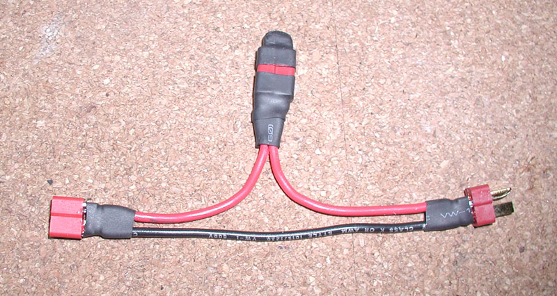

Have you looked at these:
http://www.rcaccessory.com/index.asp...ROD&ProdID=215
Mark

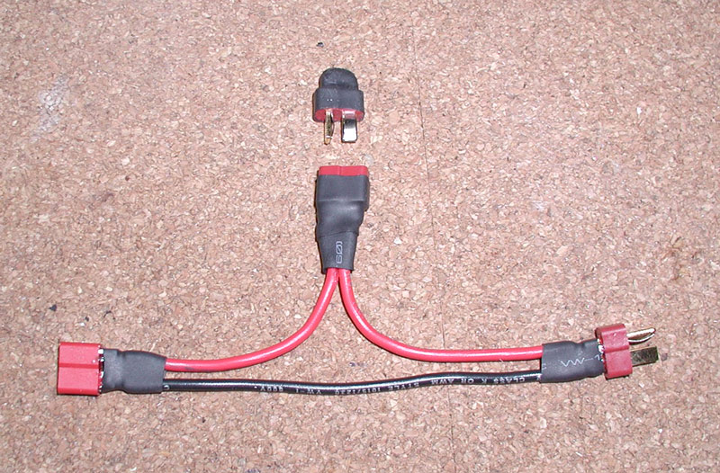

It's a simple idea: bridge a male Deans connector with a suitable conductor (brass, copper); insert a female Deans in the red lead from the battery to the esc; mount it to the fuse and use the male as a plug. Neat, clean, quick and unobtrusive.
Walt
I'd offer to scan you a copy, but I'm in the middle of moving to my retirementhome and my scanner is unhooked.
Walt
I am using those pre wired shunts ... its the same as those seen above. I hve to say that it works fine and on a 10S 60A set up the switch does not heat up.
What I like about them is that you can attach the plug to your plane, its got a bracket like the switches that we use on our plane for the RX.

at the Flying Tigers field we require the use of a removable shunt type circuit on epower planes. There is just no question of whether the plane is alive, if you have the shunt connector in your pocket. It is the last thing you plug in before flying and the first thing you remove after landing.
Some fellows use Dean's ultra connectors for their shunt connector others use Anderson power poles, both work great and totally safe.
A switch with the necessary current handling capacity is usually too large and heavy to be really practical. And then, which position is off or on? Did you bump it accidentally? Make or buy a safety shunt circuit, you won't regret it.
ciao -rjf
ciao -rjf

The advantage of using the switch is to allow you to quickly and easily arm/disarm the power system after you have installed the battery(s) and assembled the plane (ready to fly). With the switch disconnected, install the battery(s) and connect the battery to the switch. When you are ready to fly, insert the plug to arm the system.
The ideal setup would be to mount the female part of the switch somewhere external on the fuse that is accessible (similar to the receiver switch for glow planes). This will require fabricating a mounting plate for the switch (or just let it hang out through a hole in the side of the fuse).

Arming the plane before putting the wing on defeats the whole purpose of the safety switch. Mount it smoewhere on the fuse away from the prop arc and easily accessible when you are ready to fly.
Walt
