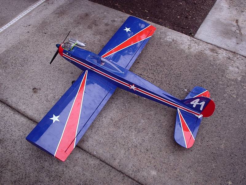

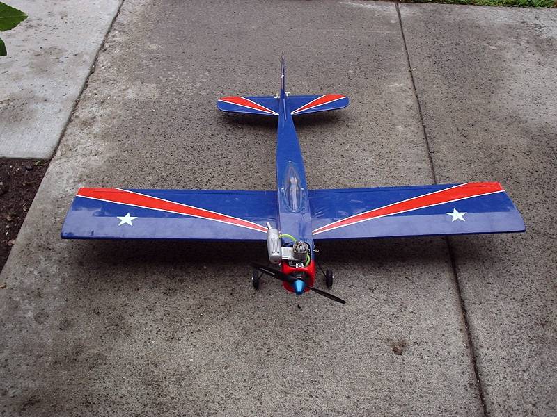

I have a world models aircombat series model that I am converting to electric and was wondering if the following electronics would work, it is a .25 size plane with a 47.5" wingspan.
- great planes ammo 28-45-2700kV motor (I have it lying around)
- castle creations thunderbird 54 esc
- 11.1V 1900maH battery (just for motor, will be running a separate battery for receiver and servos)
- what size prop should I use
I am also looking at getting the great planes gear box which has the following gear ratios.
2.5:1, 3.1:1, 3.6:1, 4.5:1
2.1:1 with 16T pinion and 40T spur
3.1:1 with 16T pinion and 50T spur
3.6:1 WITH 11T pinion and 40T spur
5.5:1 with 11T pinion and 50T spur
I currently have an os 40LA on the plane and would like the same type of speed and aerobatics or better.
any help would be appreciated.

I don't know the rimfire motors but the specs seem to be ok for the model. Another possibility is the scorpion 3020-12 with an 11*7 apc e. You need to look at your batteries though as I think that you will need more than 1900mA capacity. I think that mine weighed about 3 1/2 lbs so 400-500 watts will give a good performance.
Chris.

Please put my mind at rest. Have you carried out a recovering job or do they come like that in the US. The ones in the UK are very plain and nowhere near as smart as yours.
Chris
Old 10-25-2008 | 03:19 PM
Joined: Oct 2004
Posts: 20
From: las vegas, NV
Default RE: electric conversion question
The plane came all blue, and I just used peel and stick covering to get it to look like that.
