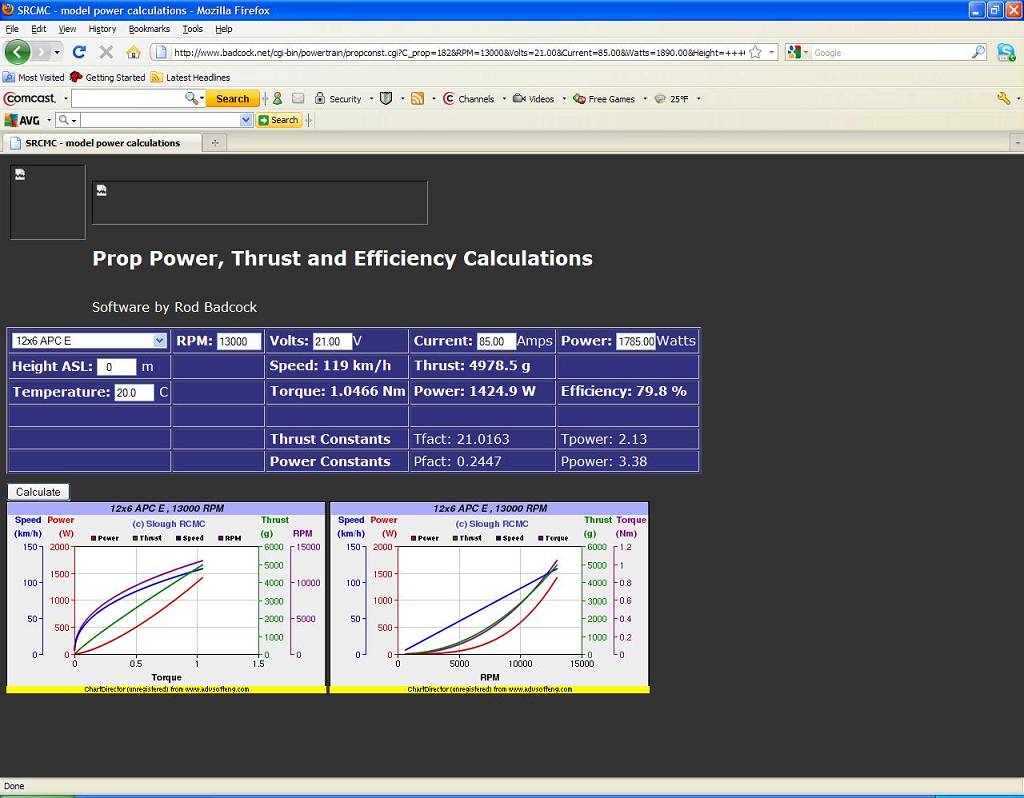

Old 01-13-2011 | 06:18 PM
Joined: Dec 2002
Posts: 2,198
From: Chattanooga, TN
Default RE: nitro to electric conversion- formula
Also, if the model says it uses a 12x6 prop with nitro (13K RPM) what would be the formula to get that performance from electric?
Using the Badcock calculator you can see that to get a 12x6 APC E to 13000rpm from a reasonably efficient motor (80%)... you need about 1800W...
6s (21V) and 85A might do it.
