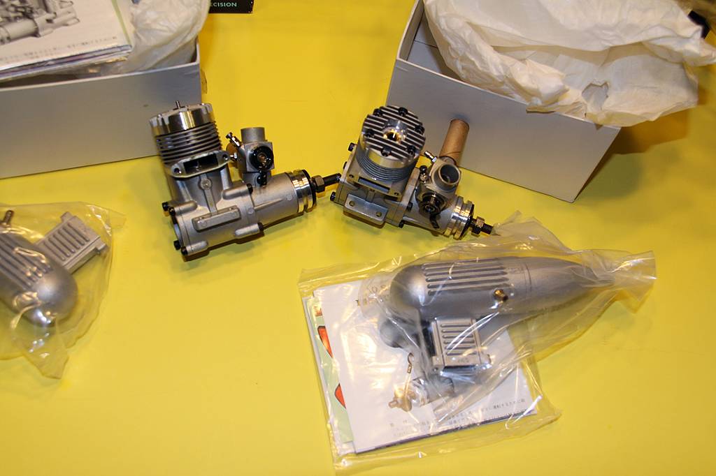

Ed is just looking to stir up trouble.
me too[>:]...eat yer heart out Ed.......2 NIB 40FSR's....70 bucks each a couple months ago.
best engine series ever from OS

Good catch. Only problem Isee with them is if they crash hard and the muffler bolt holes break out of the cylinder.
Old 09-21-2010 | 04:11 PM
Joined: Feb 2007
Posts: 3,996
From: fresno, CA
Default RE: 40sr
ORIGINAL: jeffie8696
Good catch. Only problem I see with them is if they crash hard and the muffler bolt holes break out of the cylinder.
i don't intend to crash them.........actually, i haven't crashed anything in quite a number of years now
i know what you mean tho, i just dream that someday OS will wake up and make a fine engine like these were, but you know what they say about daydreamers
