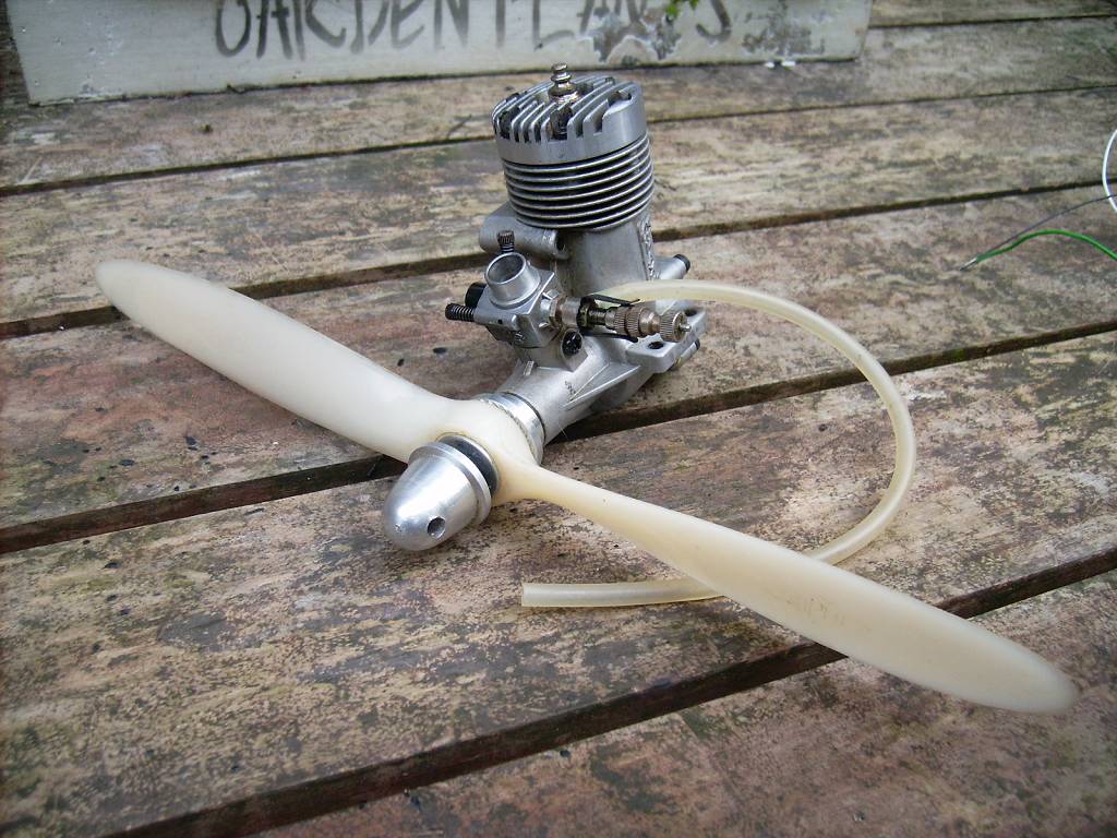

Spaz, is your .72 one of the red ones or the earlier Q-72 like this one, just curious thanks, Dave
PS, check that the head bolts are tight, these ones came loose once when it was about two years old. They never came loose again.

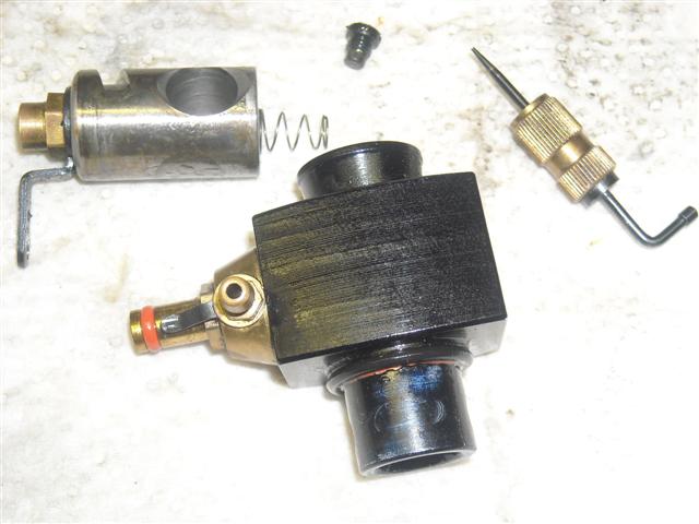

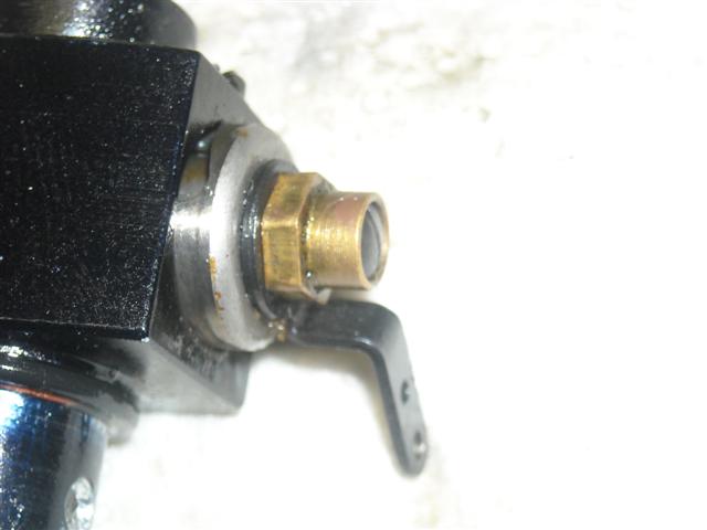

Spaz, most likely your carb is virtually identical to this one from my .72, note LS needle is even with the end of the brass nut, HS needle was set at 2.5 turns out from closed. This .72 ran perfectly at these settings.

Success!!! Hobbsy, your post did it. I was on my way to take the carb off and do some test as per Taurus when I stopped to go online again and saw your message and pictures. The settings for the needles are almost dead on. This time when I primed it and flipped the prop it ran like old times. I will need to do a little adjustment but not much. I would have never opened up the low speed needle that much if I had not seem your picture of your setting. Also the high speed needle was open more than I would have thought. You were right about the carb, it is the same as mine. Once again, I would like to say thanks to Hobbsy and Taurus for you help, this is were RCU really shines.

Taurus, your question about the second needle, I am assuming to be the low speed needle, needing adjustment was likely to come from the initial attempts to get it started. The problem was the high speed barrel having rotated the orifices out of alignment and blocking the fuel flow. After I got the high speed needle fixed, I had fiddled with the needles and did not realize they were so far off. I did read the instructions that came with the engine and I don't think they suggested so many turns. I never counted them but I think the low speed needle must have 8-10 turns on it now.
