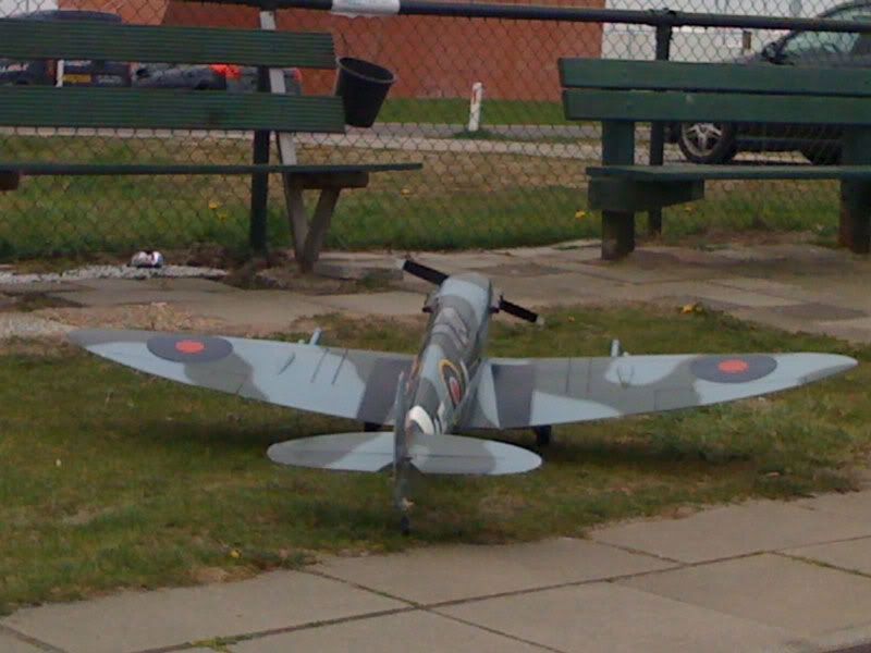

Hi all,
First of all my sincere apologies if what I'm about to ask has been handled in some topics before but I couldn't really find something that could be of any help.
Here's the thing; I have a Saito FA120 fitted inverted in a Spitfire and the first few flights were not as relaxed as I hoped whereas the engine can really be a pain in the *ss to start [:@]
Here's my setup:
Saito FA120 inverted
O.S. F glowplug
Kavan 17,5 fl oz tank, centerline fitted slightly under the spray bar.
felt clunk
18% Synthetic (Klotz) 10% Nitro
Idle and high speed needle are set correctly.
Here's what I do to get in fired up:
Fill the tank
Hand on the exhaust to get the fuel to the carb entrance, and just that in order to avoid a fuel lock.
No priming.
Check for a possible fuel lock by turning it over a few times.
Throttle stick at idle.
Attaching a glow-plug igniter.
application of the electrical starter.
In the first attempt the Saito starts and runs flawlessly but when the engine cuts for whatever reason, it won't start again. Then I have to turn the Spitfire upside down and place it in a stand in order to get engine going again. But even in a stand having the Spitfire upside down it can take up to several attempts before the engine finally fires up.
I've tried new glow plugs, let the engine draw in fuel by itself... and what not...
I'm convinced that there must be something I forgot but what?
Many thanks in advance!
Etienne

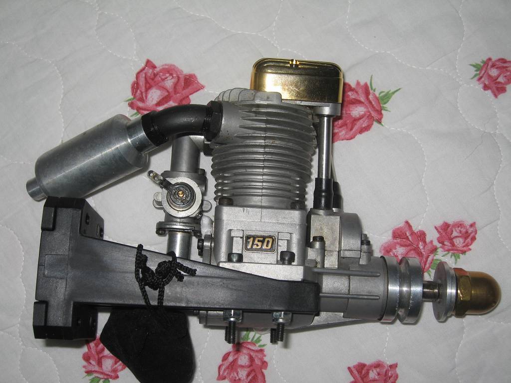

@Richard
Yep, it's an old ABC gold plated rocker cover FA120S but just broken in. I had the engine for quite some years but it's later used in this Spitfire.
It turns a Graupner 15x8... well, not in the picture but that MAS was soon replaced after this picture was taken.
Well as I mentioned earlier the centerline of the tank is indeed slightly below the spray bar when the Spit is sitting on its main gear. The recommendation of disconnecting the pressure hose from the exhaust is something to think about as I didn't test that yet.
The main problem I'm struggling with is that the engine just won't seem to start shortly after it died. It's like something seems to clog up the plug which I would suspect fuel or oil residue left from the first run. When the Saito stays alive after the first start, she runs great on the ground and after take off but after a flight when the engine is stopped and the Saito is started shortly after that it just refuses to fire at all
@Richard

I see a couple Super Chipmunk in the background of your pics. I have the GP Giant version that I plan to put my FA180 into. I may convert it to gas/glow with a glow plug or to gas with ECDI.
Sincerely,
Richard

Hey buddy you left out some of the best pics! ;-)
Sorry that the spit didn't get a chance to fly today... And steal your prop so your chip was grounded too :-P

in fact i've decided to install my new SAITO FA-150s INVERTED on my Giant Super Sportster !
