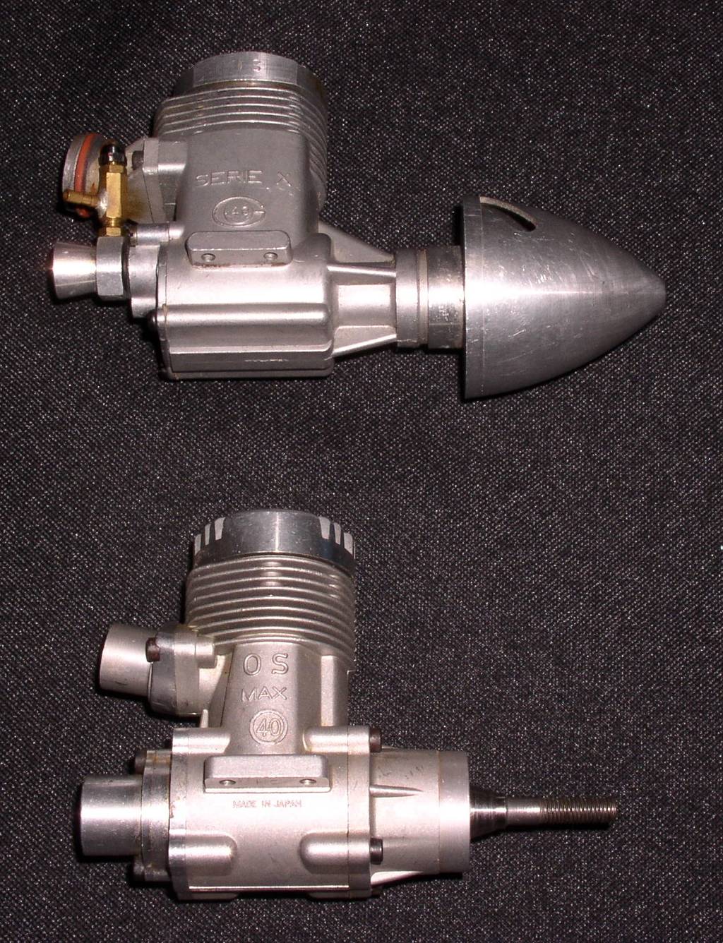

This was 6.5cc class engine. The Picco of that day was a tank in weight, strength and power as I remember. The weight was rather crippling in the air, I don't know about the marine application. The K&B 6.5 was dated by the time the OS came yet could still out run it even with its rather restrictive inlet (the K&B had true ABC P&L). Did OS ever start on the road with ABC? As I recall they tried to ride the coat tails of Super Tiger with the term "ABC type" to masquerade their ABN liners from the very start of the aluminum ringless piston craze. In the end it was the Super Tiger 40X that was dominate.
As for nostalgia the good old days really weren't so good for this OS engine or the follow up OS40PS. Now the ringed FSR is an engine even I still like and have in my mouth balled collection. I don't know how many OS 40 VR-P I have in the bottom of my junk drawers even with the PS ABC liners as a testament to my ignorance.
I know this is RC Universe but I think it is best to use the engine in a class of competition that is NOT engine dominate, like CL aerobatics.
All the best,
Konrad
P.S.
Note the one I show is the last of its kind with the rear rotor drum.

Why wouldn't you want a rear inlet engine in a C/L ship. True I'd rather have the OPS but this OS would work admirably in a low power set up.
This is the rear rotor disk model rather that the rear drum I show.
All the best,
konrad

There's nothing actually wrong with using a rear induction engine for CL stunt so long as the port timings are suitable which would generally make most RI engines unsuitable because they're usually set up for high power at high revs. That said, MVVS had a rear induction stunt engine (a 56 IIRC) which one of our better flyers here in Australia swears by. The only real disadvantage I can see is that they'd be more difficult to prime unless there was an opening in the side of the cowl to get at the intake. A slight advantage is that it would put the intake much closer to the tank.
The 40 VF's gathered a wide following in CL stunt for two reasons. The first was that they gave a lot more power when piped (about the same power as a muffled ST 60) which allowed the the use of thinner, less draggy, lines because of a loophole in the AMA rules which based line diameter on engine size, the cut off being over a 40 size engine. The second reason was that the VF's have very mild timing (actually identical to some well known CL specific engines) so they didn't need to be revved hard and could turn large props for high thrust. Interestingly, although VF's have been used for many years now, I haven't heard of a single case of liner peeling but I'd put that down to the fact that most CL flyers use a generous amount of oil in the fuel and the lowish (~10,000) revs they're run at.

Thanks DU.
As I suspected there is no reason not to use the VR as a C/L nor the VR-P. While the VR-P does have a little longer blow down period than what I'd look for in a C/L engine it should be easy enough to rework by lowering the sleeve. Also the inlet timing as I recall really wasn't suitable to pylon racing as delivered. So it should work fine for C/L work.
Now to be clear I don't, nor do I think anybody here is, advocating that the VR-P be considered as one's first choice for a C/L engine.
It is that on the face of it C/L might be its best application. Not that it is the best for C/L.
Friends don't let friends.........
Konrad
