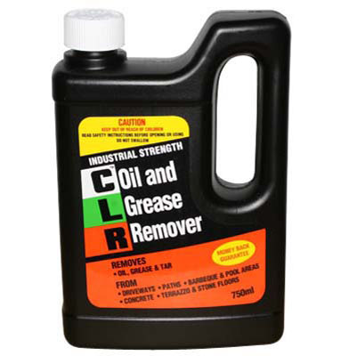

A trick I learned about not long ago from another model forum for cleaning rust from steel parts is to immerse them in white vinegar and let it sit for a day or so. It works a charm but I wouldn't do it with bearings. I've never actually seen a rusted bearing but I've felt some that I thought might be rusted, either totally seized or extremely lumpy. All of them only had hardened castor in the races and, after cleaning, were as smooth as silk. I've cleaned bearings by soaking in warm water and dish washing liquid, acetone and in a small ultrasonic cleaner with a little CLR (Oil and Grease Remover) added.

The original CLR stood for Calcium Lime and Rust (in a green bottle I think) but the later one in a black bottle is the one to use. And I'd hope the engine in my photo had never seen methanol because it's a diesel
. That corrosion would have been purely galvanic corrosion between the iron in the bearings and screws and the magnesium crankcase. Strangely, the spare crankcase I had was given to me after it'd been under water in the '74 Queensland floods (like what's just been all over the news lately) and I'd just thrown it in a drawer for all those years yet it was perfect, including the bearings.
