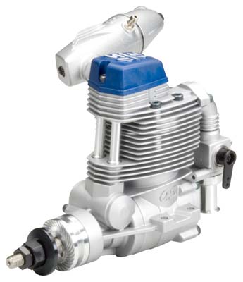

ORIGINAL: landeck
There is a vent located on the cam box. This is where you put after run oil. You also use fuel tube to vent the oil coming out of the crank case to the outside of the plane. How is this different from a Saito?
Bruce
Bruce,
my english is not so good, so could you please further explain this:

Old 09-09-2011 | 03:27 AM
  #28
Joined: Nov 2007
Posts: 1,710
From: Sandy Springs, GA GA
Default RE: os fs-95v
Kostas1, from what I have seen your English is quite good. The vent/nipple is on the cam box which holds the cams which push the rods up to operate the valves on the engine. It is located in front of the cylinder on the crank shaft. On this picture of the engine:
http://www3.towerhobbies.com/cgi-bin...&I=LXAVCS&P=SM
the cam box is the round object with the two rods coming out. The vent/nipple is on the far side of the cam box and is therefore not visible in the picture.
Bruce
Old 09-09-2011 | 06:43 AM
  #29
Kostas1's Avatar
Joined: Dec 2005
Posts: 3,566
From: AthensAthens, GREECE
AAAA i got it Bruce!
Thank's a lot for pointing that out to me!
