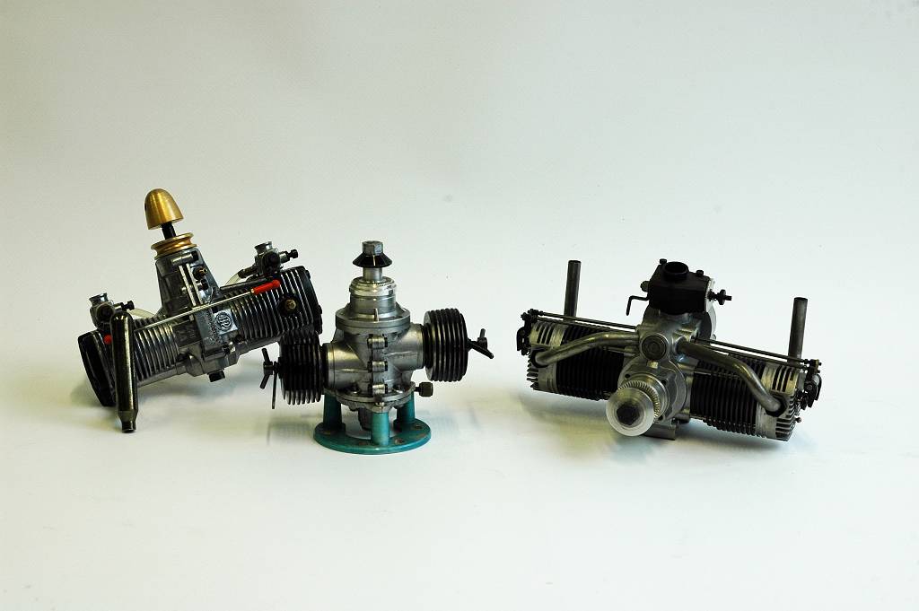

Here is the inside of the HP VT-21 twin

Reggy,
Here is a much better, larger photo; from which one can see the details.
This is a wrong crankshaft! If anything, Hirtenberger should have used a 180° crankshaft, to achieve even 360° firing intervals and a much, much better balance.
The con-rods would also be more conventional; instead of the 'knife and fork' arrangement.
This engine, as designed, has 180°/540° firing intervals and a single counterweight...

These engines were not built by HP but by Dietmar Kolb from Germany
Here is the engine from my collection

Reginald have you built one of these?...
I think ive figured out the crank and rod setup. I dont know anything about 4 stroke engines. How do the valves or pushrod things work on a 4 stroke?
Would this engine be reliable enough to fly a plane? As cool as the engine is I dont see a reason to build a engine to set on the shelf. And I dont even know what kind of power the twin would put out.
