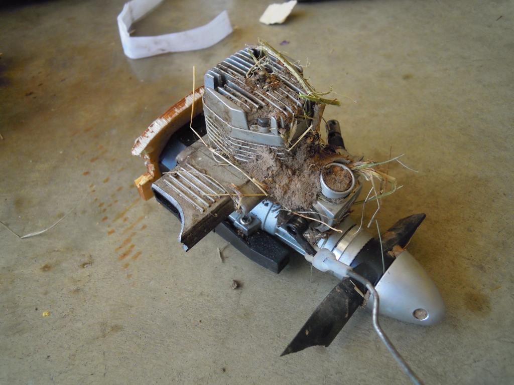

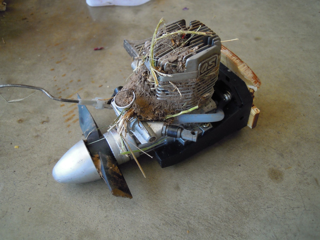

Hey guys I had a "incident" with my Escapade this morning and I had to dig my OS 55AX out a crater. See pics. Just wondering what the best way to handle this clean up would be and any ideas that I may not have heard of to get it clean and running again. I was going to clean it with some carb cleaner then oil it up with some ATF. I got a new airplane on th way so I would like to have it running agin in a few days if possible but want to do it safely. Thanks!!!

If any dirt got down to the crank I would tear it down and clean it.

I think you'll be taking that engine apart. Looks like it hit dead plumb in soft dirt so the crank shaft might not be bent.
Hose it off, strip it down, clean the parts, oil them put it back together.
or put the parts in a bag and send it to the service dept asking them to call you with a price.
Old 08-14-2011 | 11:03 AM
AmishWarlord's Avatar
Posts: 2,939
From: Indian Trail, NC
Default RE: Post-crash clean up
ORIGINAL: huck1199
If any dirt got down to the crank....
I think I see some dirt in the carb. Or is that some carb in the dirt?

Complete teardown inspection, soap and water then dry and oiled.

Carefully brush away all the dirt and then remove the head and back plate, flush all the parts with ALCOHOL, do not use carb cleaner as it will attack any silicone O rings. Dry everything, oil up the parts with some light oil and put it back together.
lucky for your engine, the dirt looks rather soft

I would hose it off first with a strong stream of water WITHOUT TURNING THE CRANKSHAFT! Then quickly disassemble it Dry it and then oil all the parts. Inspect the crank to see if it is bent, and if not reassemble using oil and you will be good to go.

Don't forget to dis-assemble the carb barrel and clean it up.

that's the best advice posted.............but drop all the parts in a tub of acetone with a suspended basket.
take the time to take each piece out one by one and thouroughly clean, inspect and dry, placing parts on a clean towel. then light lube while reassembling. you can't be anal enough about cleanup of an engine in this condition.

Well I tore it all down piece by piece and hosed it off real good. I did find some dirt down low but I was very careful to not turn it over while I took it apart. There does not seem to be any damage that I can see. I am very grateful that it landed in some very soft dirt because it hit HARD. I did indeed find some carb in the dirt on the front of the engine and it was still stuck WIDE OPEN!

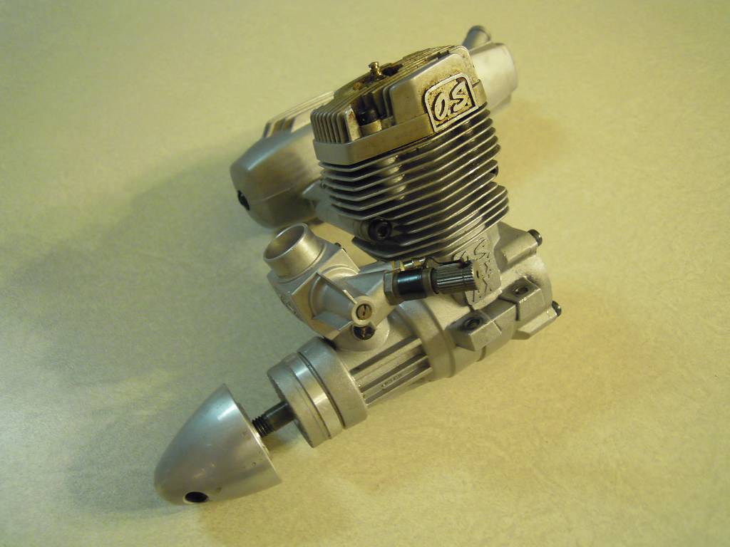

Old 08-14-2011 | 06:07 PM
TruBlu02's Avatar
Joined: Jan 2004
Posts: 842
From: Sambach, AE, GERMANY
Here's the post clean up shot. It looks good as new and turns over nice and smooth. No bent crank either!
