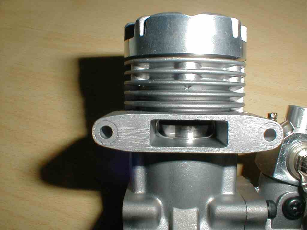

I know that ABC engines have that characteristic "lock" at TDC with the glow plug removed, and the engine seems to slightly "lock" at TDC with the glow plug removed...... The guy at the hobby shop said it's ABC because the piston doesn't have a ring.....The piston has the appearance like it's made out of stanless steel...Here's a pic of it

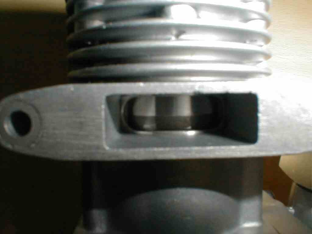

Now with the piston at TDC.

Those ridges on the piston tell me it is cast iron. The instruction manual should identify it. Also the top of the new piston will be darker.

Sure looks like cast iron to me with that darker relieved area near the bottom of the piston. Get a small magnet and touch it on the piston.

Then I should follow the procedures for breaking in a non-ABC engine .......Thanks alot again
