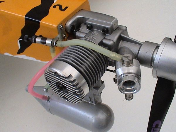

Can a remote needle valve be put on a OS46FX?

Hi!
Can be put on any engine!
ID:	1661202   Click image for larger version

Thanks, but I'm not sure were or what I need to do this.

remote needle valve and bracket for the OS46LA. nice unit readily available.
Os has a all metal remote needle valve that works well but i think it is made for a smaller engine, medium size fuel line fits a little loosely on it.
Mecoa also has a nice remote needle valve for a K&B also a nice unit

Just buy a spare needle valve (like one from MVVS) and mount it on a bracket made from 2-3mm mm epoxyplate, alumium or plywood! And... cover the old needle hole with a thin plate, soldered on.

ORIGINAL: jaka
Hi!
Thanks I'll try that

If you use a remote needle, you don't even have to remove the old one. Just open it enough that it doesn't restrict fuel flow. Just make sure it cannot vibrate out. Most needles are fine when set to 4-5 turns out from closed.

And you aren't going to solder to aluminum.
