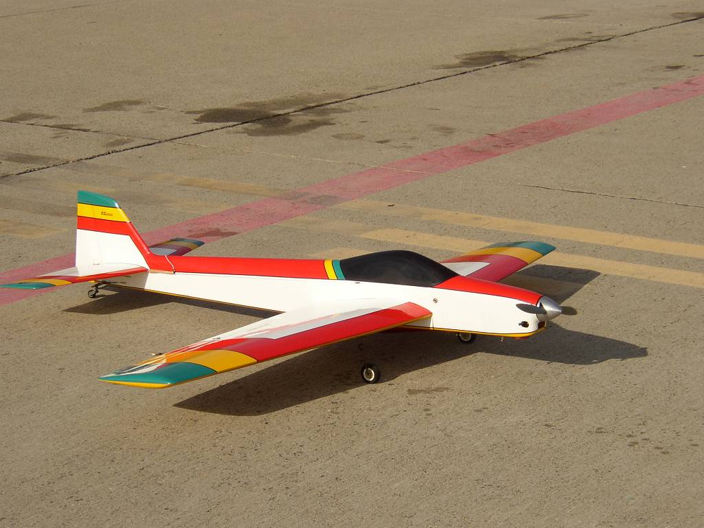

Tried a ton of different props but this last flight we were running an 11 x 7 just because I couldn't shorten the pipe any more out at the field since I'll have to take some length off the header and the 11 x 7 hit the pipe just like it should.
I've always used Cool Power 10% unless the LHS was out and then I'd use 15%. Haven't had any issues there and like I said, she runs fantastic on the ground.
I've got a shot of it in the photo gallery but to save you having to go looking, here she is............

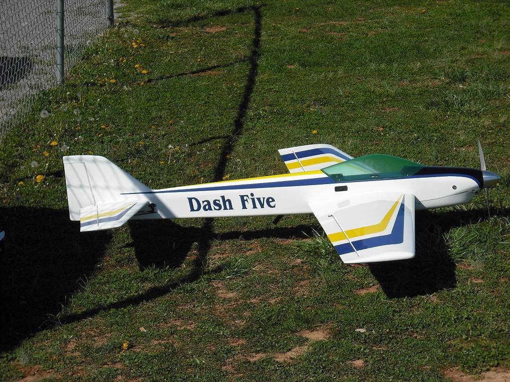

Here is mine built from scratch with a friend's set of plans. This picture is after the upgrade to the O.S. Hanno.
