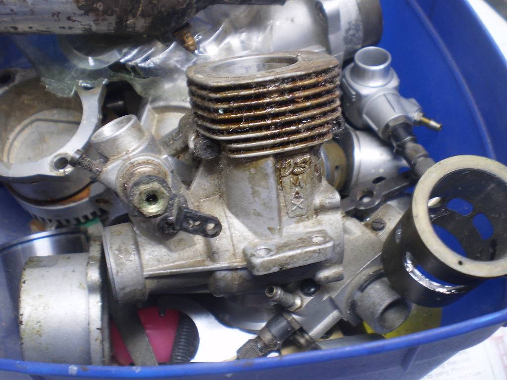

Got a 32 , not quite burned down , but gummed, will do a clean up and a bearing and a C/L convert , that makes what 5 engines for my plane , Im ecstatic
