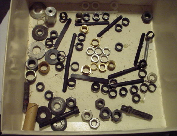

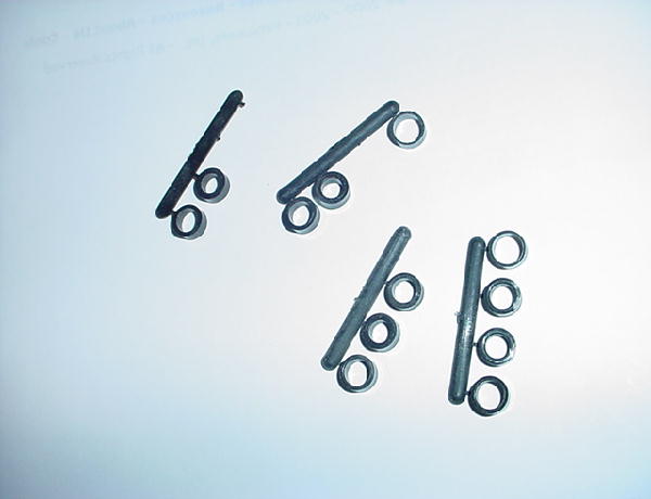

My Feedback: (21)
Ask one of your flying buddies, or someone at the field
if they have any of these plastic spacers. They come with
new spinners....so that the spinner will fit on all engines.
They are very common....ask around....
....don't get hurt by a silly mistake with a propeller....
Dave.
Dave.
