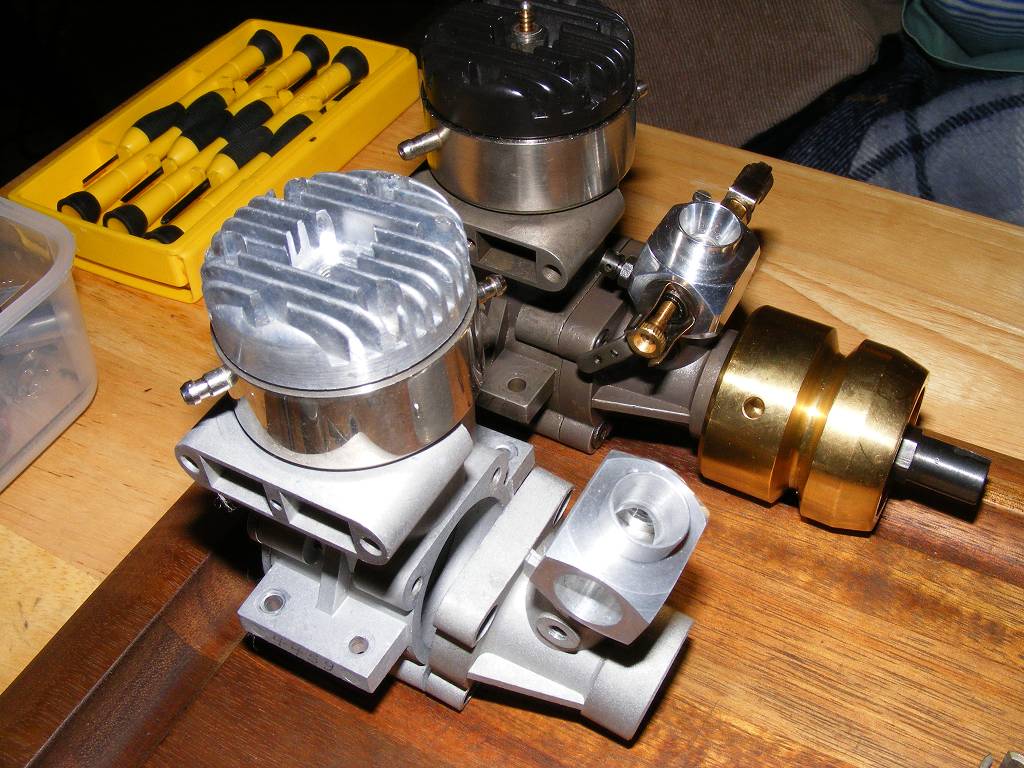

Can anyone recommend a good engine cleaner that will dissolve burned on varnish ?

Dawn Power Disolve spray from the supermarket kitchen cleanser aisle, or automotive atifreeze in a crockpot. Do a search here on RCU for how to.

I have cleaned some really funky,nasty,dirty engines with the Dawn and it makes them look good as new. The crockpot method works well too, you will need to disassemble your engine to remove any plastic or rubber parts from it first though. I would recommend replacing the bearings after you clean it with the crockpot method. DO NOT plan on ever using the crockpot again for Human food!!
Also, should you have any pets around while you are using the antifreeze method , DO NOT let them get anywhere near the crockpot. Dogs/cats are sometimes attracted to the sweet smell of the antifreeze and shoud they drink it, it will kill them.
If you are just trying to clean the outside of your engine such as the crackcase and carb , I would say the DPD would be the least effort with the best results. Get you a stiff old toothbrush to get into the nooks and crannies after you let the Dawn sit on there for a little bit. I think you will be pleased with the results.

For the Power Dissolver, just sray it on your engine and let it sit for 30 mins. Then take a old tooth brush and give a scrubbing. Plug up you openings and rinse it under the faucet. If you have some real stubburn spots you could try a soft (vesy soft) wire brush.

Read thread here on RCU on engine cleaning. Follow Dawn PD mfr directions. Close off all openings of engine. Spray Dawn PD liberally on affected areas. Let stand no more than 30 minutes (engine caastings may turn darker grey if left longer) Scrub with stiff toothbrush (don't brush teeth with this one again). Rinse off with hot water. Dry thoroughly inside and out with hot air blower. Rinse with alcohol. Lube liberally with afterrun oil or Marvel Mystery Air Tool Oil or ATF, turning engine over by hand to insure oil gets everywhere in engine, including bearings. As always no intended or expressed warranty for suitablility of this methed for your application is expressed. Good luck

The Dawn Power Dissolver I got at my local Wal-Mart is of the gel type in a bottle, not the spray on as you described. It does say for pots and pans as prescribed.
I put it on with a towel, spread liberally, let set for 30 minutes and then scrubbed with a tooth brush. Took off some of the stains but not the crusted on type. Plan on getting a soft wire brush that may be more aggressive in taking off the stains. I can take a exacto knife and scrape off the stains, so I think they are loosening up some. Don't want to leave any scratches on the engine casing.
Will try a second coat tomorrow
OK I seen what I done. I got Dawn Power Clean, not Dawn Power Dissolver

Was able to get the Dawn Power Dissolver and man did it do a wonderful job !!! Cleaned up 6 engines and looks like new !!! I'm sure they will run 10-15 mph faster without all that crud on the engine .
