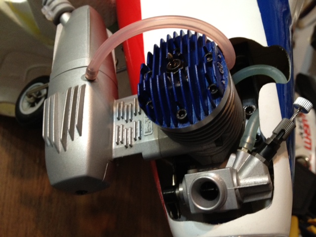

Ok, ran the engine sunday and the tank issue seems to be better with the dubro 14 ounce tank. I tried a few different props and saw 14,700 rpm with my TNC tach and a 10 X 6 APC. Engine does seem to be happy with the higher rpm. 10 X 8 dropped off to 13,500 and the 11 X 7 was down to 12,500. Running a bit on the rich side but at least there is an idle now and the transition is liveable to fly this thing. Going to try an APC 10 X 7 tonite to see where its at but probably fly it with the 10 X 6 and be able to land with less pitch and a slower flight speed while keeping the idle a bit higher. The engine does seem to have good power and run fine now. Too bad the carb is soooo crappy and the exhaust it comes with nothing more than a paperweight in the trash can. As soon as I can find that macs 1250 pipe it will be on there.

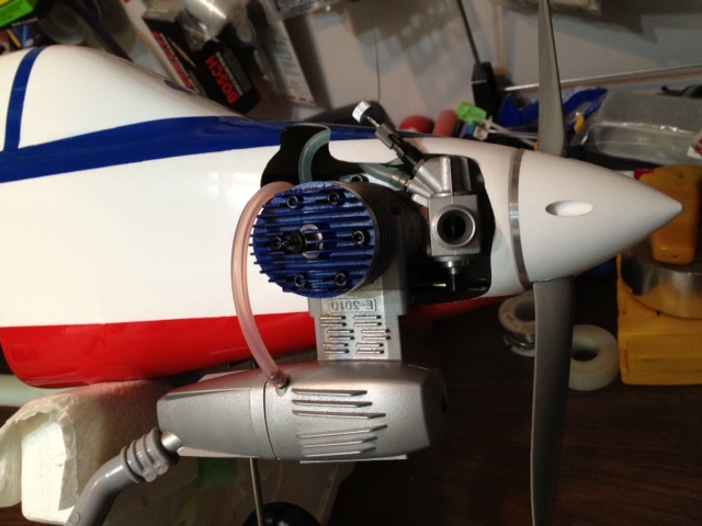

Got the maiden flight out of the way the other night and engine ran great. The only problem I had was a stuck mid range needle on the 46 size carb. Couldn't get the engine to idle real nice so, tonite I installed the carb off my OS 75 AX and will give that a try. At least I know I'll get the idle fixed as this carb works good. Also should flow some more air and get the rpms up with a bigger prop. I also have the jett tuned muffler on order. Should be able to fly this weekend..... stay tuned!

Ok, stopped by the flying field today on the way home from a boat race and flew the phoenix. The engine now purrs like a kitten at idle with the carb from the OS 75AX tached out at 14,200 with an APC 10X7 prop and the powerbox muffler from an OS 46 AX. The transition is now instantaneous from idle to top RPM. This is fast becoming my number one airplane now. She flies very nice and the engine while still on the rich side shows good power. Next week I'll try a few more props.

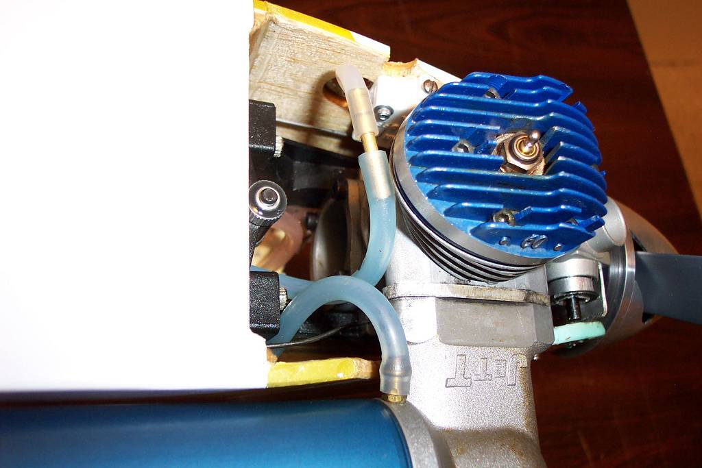

With the blue muffler it will turn an APC 11X6 @15400 or MAS 11X7 (S-2 series only) @ 15100 rich'nd for flight. I did notice that I had used a 1/8" spacer so the muffler doesn't touch the fuselage. Did this help or hurt me? I don't think it makes that much difference, but I believe in full disclosure. Note an APC 11X7 is too much prop, yet the MAS just blasts off as well as it unloads and holds rpm in hard turns. The engine is a sport beast. This engine was broken-in wide open throttle, rich two stroke, Powermaster 15%.

The other Evolutions that I've had liked being broken in wide open and run hard.
The spacer probably won't matter.
