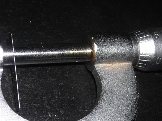

Actually a .004" guage comes with every Saito as part of the tool package, this is the tool set that comes with 1.00 and under singles, 1.25 and larger comes with a 12/14mm wrench in addition to what you see here.

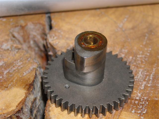

If you looked at my micrometer above you can see its sitting dead on .004", if I put an Enya guage in there it reads .002"
I took this cam out of a then 20 year old Saito 1.50 thinking it was worn out, turns out the new one is exactly the same. Note nearly flat side on cam, I thought that was the result of wear.
