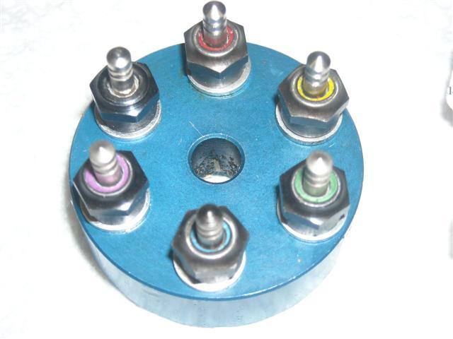

The TAIPAN plugs are very good and are color coded so you don't lose track of which is which after removing from the package. The one at the 10:00 position is the 4c, it's very good.

hobbsy - where do you get the Taipan plugs?
