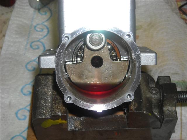

I've never seen a Saito rod get loose, I've seen lots of bronze bushed rods get loose.
