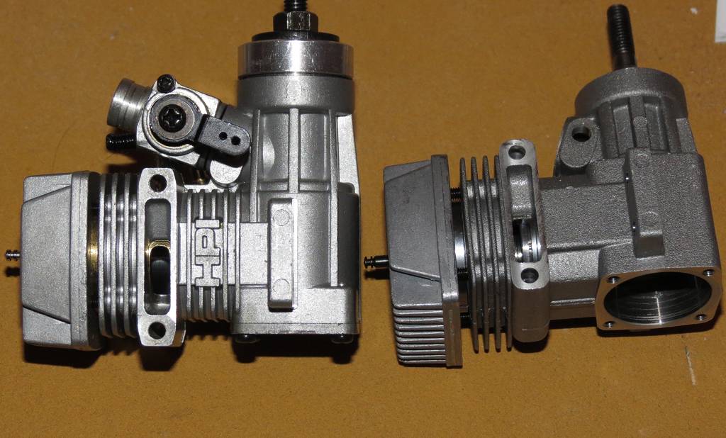

The price looked good so I got myself one of the KB .18 engines, without knowing much about them. Does anyone here have any info/experiences with these?
After a peek inside, they kind of look like a cheaper version of the HPI .18 engines...

Car engines or are those actually airplane engines? Didn't know HPI made aircraft engines. Is it stamped made in Japan anywhere?

It's an airplane engine, but I don't think that they are made anymore.

The company that bought K&B, RJL, buys old engine companies and assembles the leftover parts into engines.  They are not in the business of seriously making anything, though they occasionally make or have made a few parts.  That looks like what happened here.

I have been tempted to get one of those engines too. I was thinking of the little ducted fan, plane and engine with tuned pipe. But unfortunately they wouldn't ship the plane though.
I strongly suspect that the aero engine is a converted car engine. They had three different heads for the engine. Plus there were pull start versions and car carbs, etc. The ducted fan version used car head, a pull start, and a car carb on it.

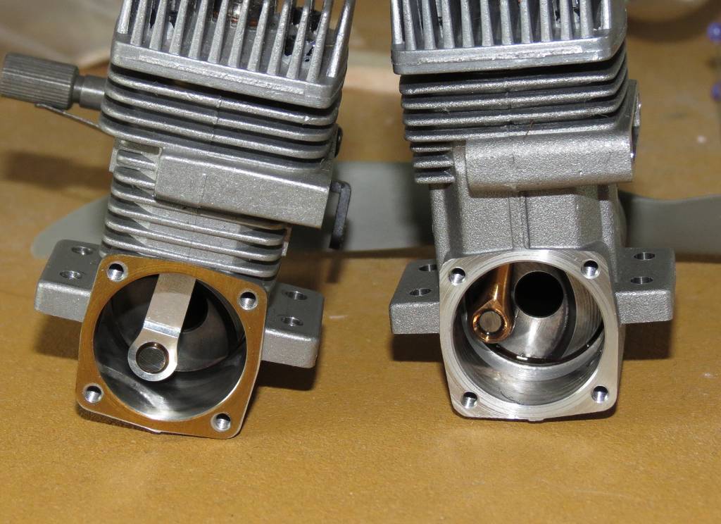

Yes, they most likely have common parts with car and boat engines, much like the OS 15CV has. The HPI one is true ABC with a strong aluminium conrod, while the KB one is an ABN construction with a brass/bronze conrod...
From a distance one can barely tell them a part (carbs are identical too);

The HPI engine is most likely made by Toki. I have an HPI .15 car engine that came to me with a blown out rear bearing.... The engine hadn't even run yet. ABN cylinder/piston, single needle car carb, bronze conrod. Stamped "Made in Japan" as the above HPI engine. I have mine over at a buddy's shop to see if he could make a prop drive for it or find a way to put a prop on it. Not strong engines, but they run. I know little about the K&B version though.
At first I thought it might have been made by OS, but I looked further and found it to be most likely a Toki.

Just to clarify, it is the KB engine that has a brass/bronze rod and the ABN technology.
The HPI is true ABC and has a rectangular aluminium rod.
I have only seen a bronze rod in the Toki .05 engines before, but they could possibly be making the parts for the KB too then.

The K&B is done by a retooled TOKI dies. The rod is a phospher (spelling?)bronze rod. It is a very strong rod with a smooth "dogbone "shape. There are no stress risers on it compared to the aluminum rod. I had my engine complete a shaft run by accident when the prop came off and nothing catastrophic happened to the engine. Compression was very good and the rod suffered no damage. The engine is anemic, though. It does not put out like MECOA say with a tuned pipe. Mabe with a flywheel.

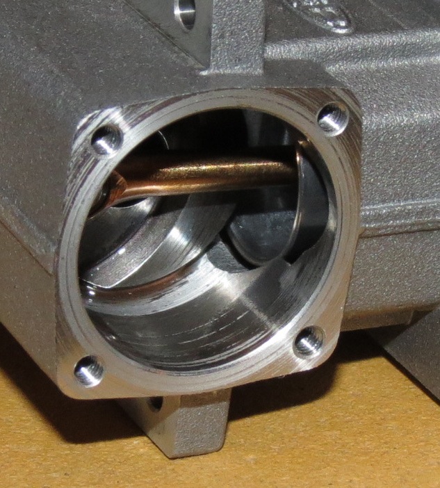

Yes, you are probably right that the conrod is strong and made with good engineering considerations. I'm perhaps a little biased from discussions in the 1/2a forum where people think the weight of a bronze rod is holding the Toki .05 back.
So it seems like the HPI engine that I have is an early one, and that they since then have moved to a "thick" nickel layer and a Bronze rod on all of the engines, Toki, HPI and KB.
I will run it and see what it gives, the quality seems fine and it has a nice pinch. One thing I found, just by looking, is that the transfers ports seem to be rather blocked at BDC. The bottom of the liner bore in the case could do with some clearing out (it is better done on the HPI). This could easily be improved with a dremel though. Here are two pictures, not sure if it will show up that well (KB first, HPI next);

I have a Fuji .05, which is essentially identical to the Toki .05 without the coloring, both made or assembled by MECOA. Yeah it is a little on the heavy side, but not bad. The RC engine works pretty good actually. But it doesn't rev up high on smaller props like some of the other 1/2a engines do. It is a converted car engine as they made a new prop adapter nut for the front of it, that unfortunately means you have to ream out the small 6x3 prop quite a bit to fit. The head is still oversized like for a car, so it might be cooling the engine a little too much too. Maybe chucking the head up in a lathe and machining a little off the top would help too. But hard to say.
The Fuji .05 or Toki 05 both come with a pretty nice muffler that would allow one to use the engines on more flying fields where noise restrictions are in place. So maybe the power or speed tradeoff would be worth it then.  But if noise isn't a problem, one could make a intake venturi dispense with the heavy RC carburetor, run the engine sans throttle. Leave the muffler off and save quite a bit of weight that way.
