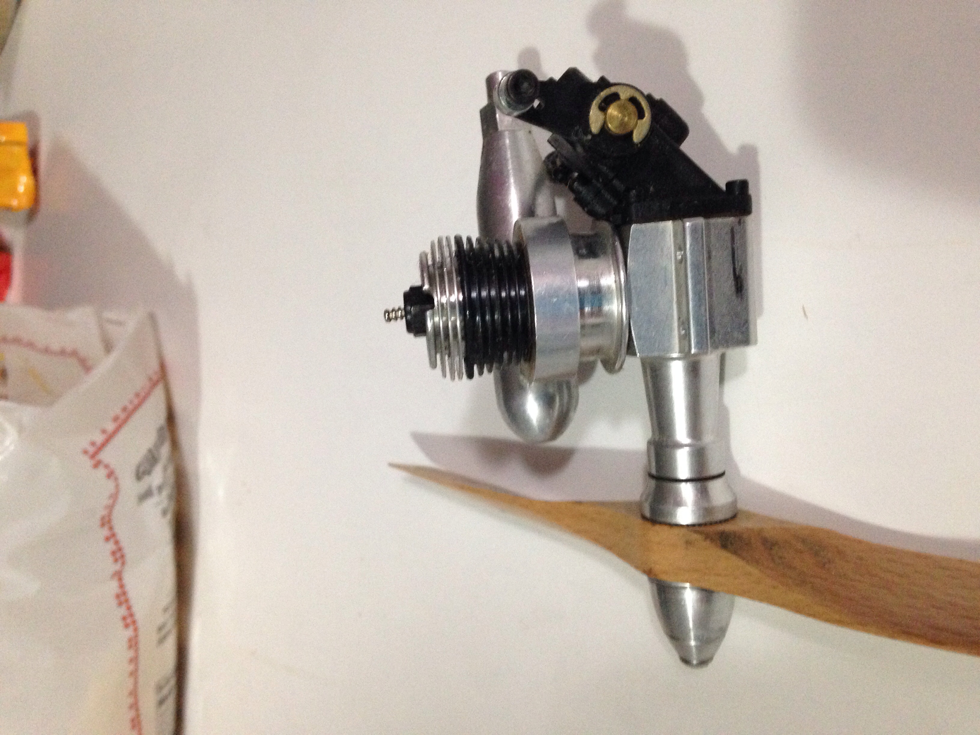

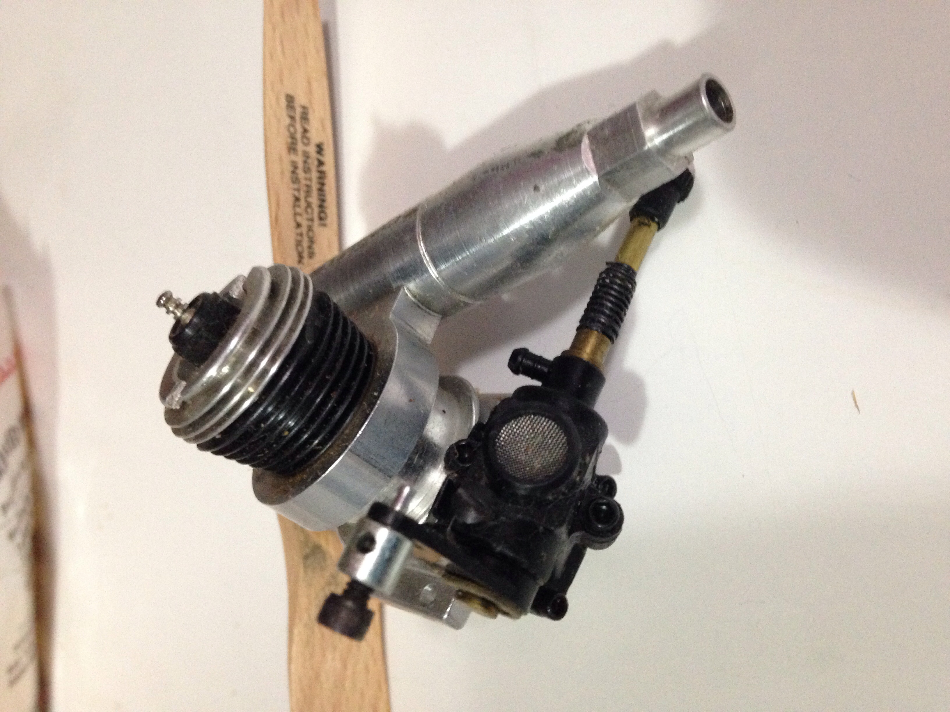

Old 07-16-2014 | 07:43 PM
My Feedback: (16)
Joined: May 2002
Posts: 558
From: Clinton, UT
Default What Engine is This?
ID:	2014846   Click image for larger version

I'm thinking a Cox Queen Bee .074 (will have to check to be sure...)
Edit: Yep...it is...
http://www.rcuniverse.com/forum/1-2-...bee-074-a.html

I concur in that it is a Cox Queen Bee .074 RC engine.

Yes 100% Cox Queen bee .074 engine. same power of a golden bee/black widow but with a not so good carb. It was heavy but did what it was designed for and that was to be a throttled 1/2A engine.
