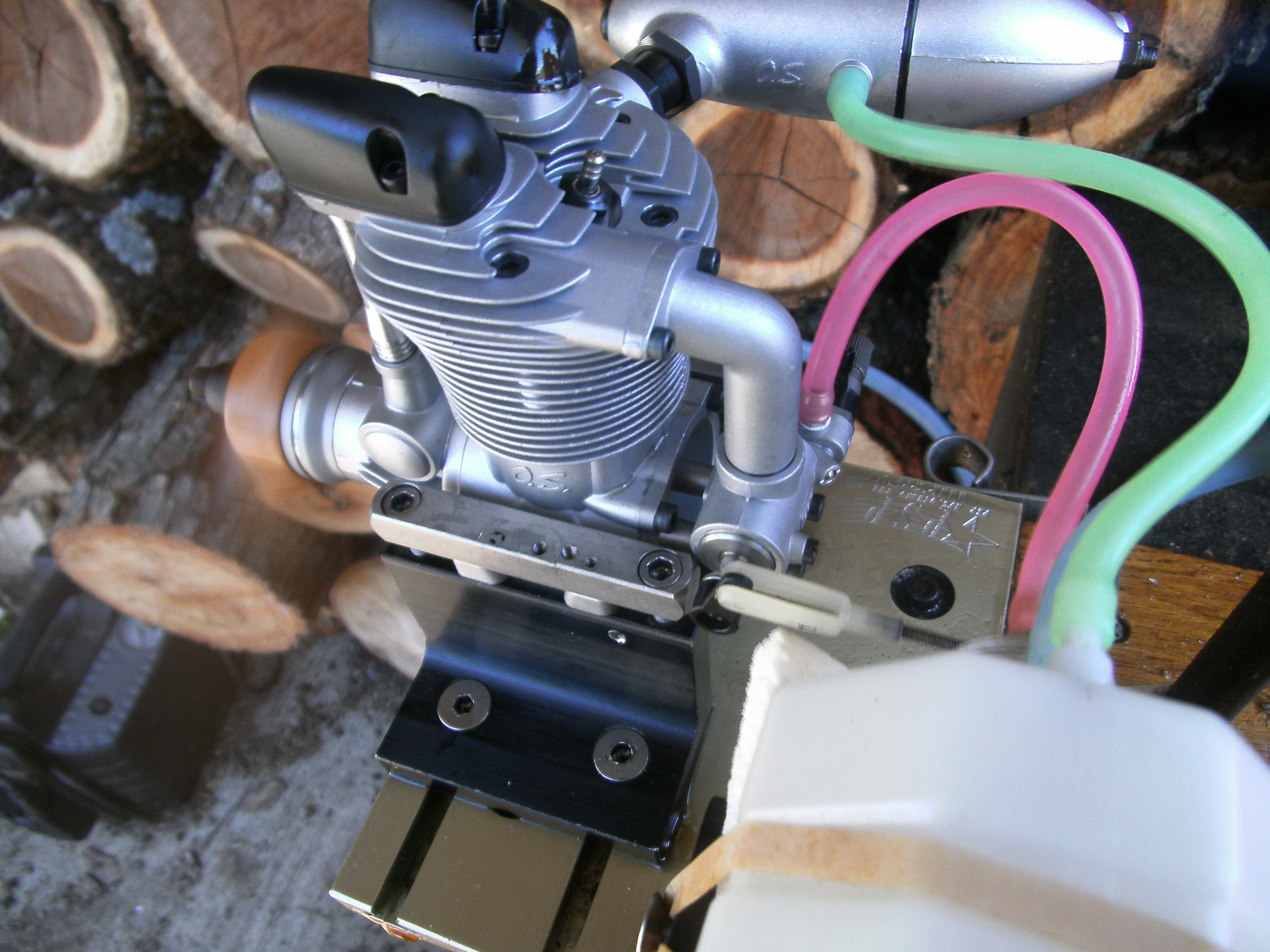

Here's the setup:
-New OS FS95 4-stroke, mounted in an equally new H9 Sbach.
-Engine is mounted horizontally with carburetor about same height as fuel level.
-Engine has never been opened up to check valve timing.
-New Type F plug.
-Byron 4-stroke fuel
-Stock muffler, with pressure tap connected to tank
Engine starts easily at the default needle setting of 2.5 turns, and makes a reasonable amount of smoke.
After warming up, engine responds normally to throttle advance up to about 2/3, whereupon it sags and will die if throttle is not reduced.
Behavior is the same as needle setting is varied from very lean to very rich. Idle jet adjustment affects nothing but the idle.
Changing plug had no effect.
Pressure tests on fuel system showed no leaks or flow restrictions.
Most mysteriously, the sagging problem disappears almost completely if the pressure tap is disconnected, as if the muffler is providing too much pressure.
Suggestions?

-Engine is mounted horizontally with carburetor about same height as fuel level. Maybe your tank level to carb allows the engine to run OK with no pressure from anywhere ! Just a guess.............
Why not? Do it. This symptom can be many things, leave adjustments like this ruled out by checking them. Troubleshooting is methodically eliminating each system.
When you state the idle mixture screw has no effect but idle, that's not true. It handles the transition. What starting point did you use for that screw? IF you do change the position of the engine, hold it upright and vertical, does the engine behave differently?

No need to check the valve timing, it will be fine if never opened up. If the LS needle is set too lean it will make the HS needle ineffective. Make the LS needle one half turn richer and see if that helps I've had a .95v for about 6 months, great engine.

OK, that's interesting: thought it only affected the idle, which is OK. I had it opened up substantially at one point, but I may be changing too many variables at once. I'll check that out...thanks.
Sagging rpm tells me it's lean. As Dave suggested, Richen up the low end and I would Richen the high end a half turn or more as well and run it up.
A little back tracking - did you break the engine in to seat the ring or does the engine have at least an hours run time at a rich setting? If the engine is brand new and not broken in, it will sag when set for a normal flight mixture setting. They need to be set fairly fat until the ring seats and seals better. New rings don't seal well and as such need more fuel/oil to help the ring seal.

Trouble is, I can't *get* to full throttle to make that setting...the engine won't run above about 2/3. I'll have to experiment with LS settings until I can get there.

OK, think I have a handle on it now. I got a good run with the LS needle open one full turn, and the HS closed 1-1/2 turns, from the factory settings. Still needs a little tweaking, but it's flyable now.
I'm at 5000 feet, which would account for some of the HS change, but I've never seen an engine go that far from factory nominal before. Maybe the factory muffler was changed after the default settings were determined, in favor of one with more back pressure.
Thanks all for the help.
