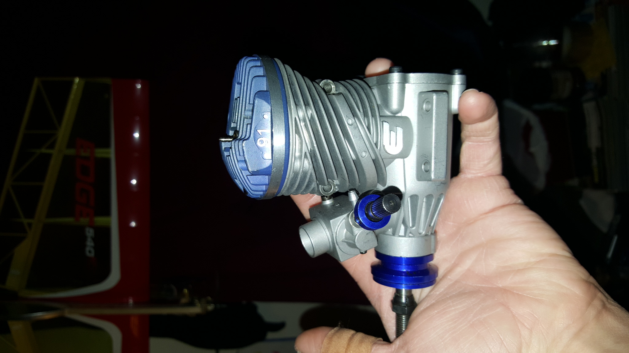

So I bought a 91nx recently because there supposed to be amazingly light, according to Horizon Hobby they weigh in at 20 ounces with muffler.
This is a lie! This motor tips the scales at 26 ounces with muffler! Now I have heard horizon has a tendency to stretch the facts but I didn't think it was true.
Anybody else out there ever owned one of these motors? I know there runners, and the one I bought is in dam good condition and I only paid $90 for it, great compression, bearings look great and the piston has very little carbon on it.
