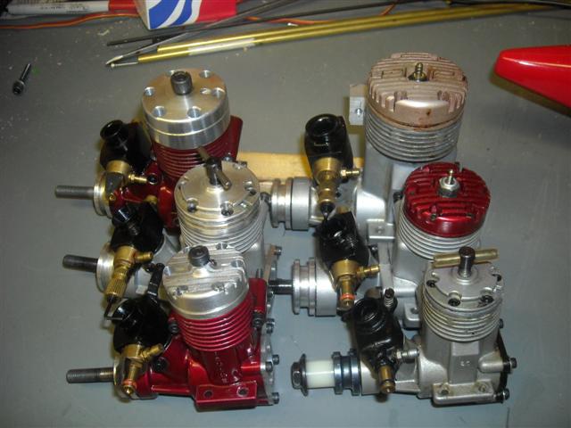

Please don't take it as I'm correcting you, I just noticed it yesterday when checking out parts availability for the .10 I bought. I found some paint at Tower that appears to be close enough to the LA blue. You could paint the 25's head red and cool it up like the Q-40 in the picture.
I didn't take it as such - no worries Dave.
I don't like paint on engines which is why I stripped the paint off the LA25 I have. If I did anything, I'd have parts anodized which hardens the surface slightly, protects against oxidation, and doesn't hinder heat exchange. Besides - paint looks cheap to me anyway. I think I'll leave this one au naturale.
