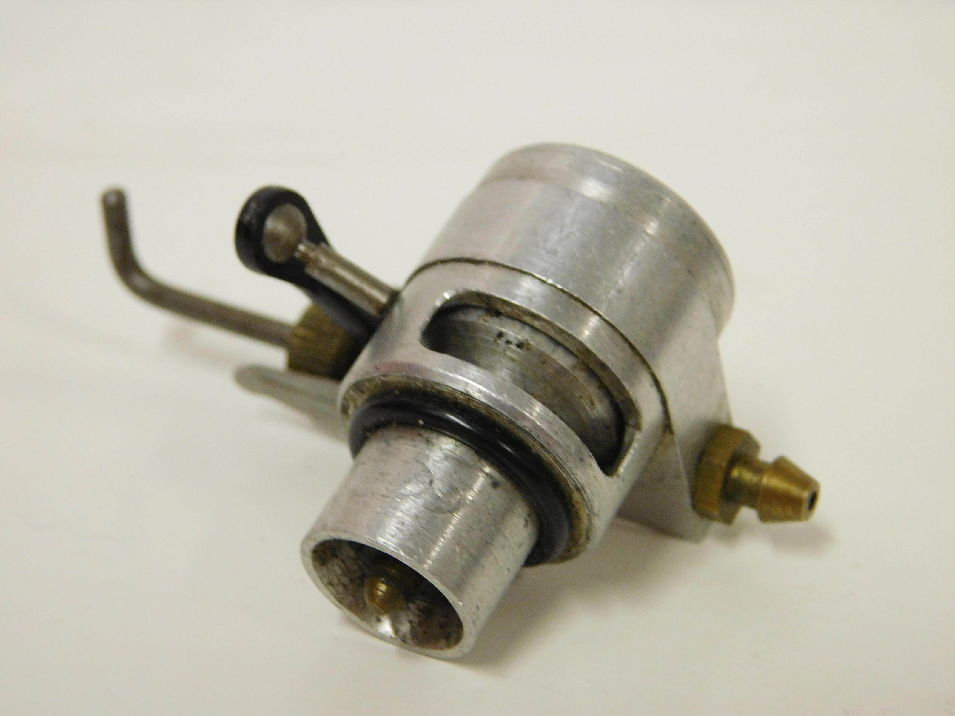

I am going to try this carb out tomorrow on a Snorer .55 for a friend in Fla. It's certainly different. It fits the Snorer perfectly.

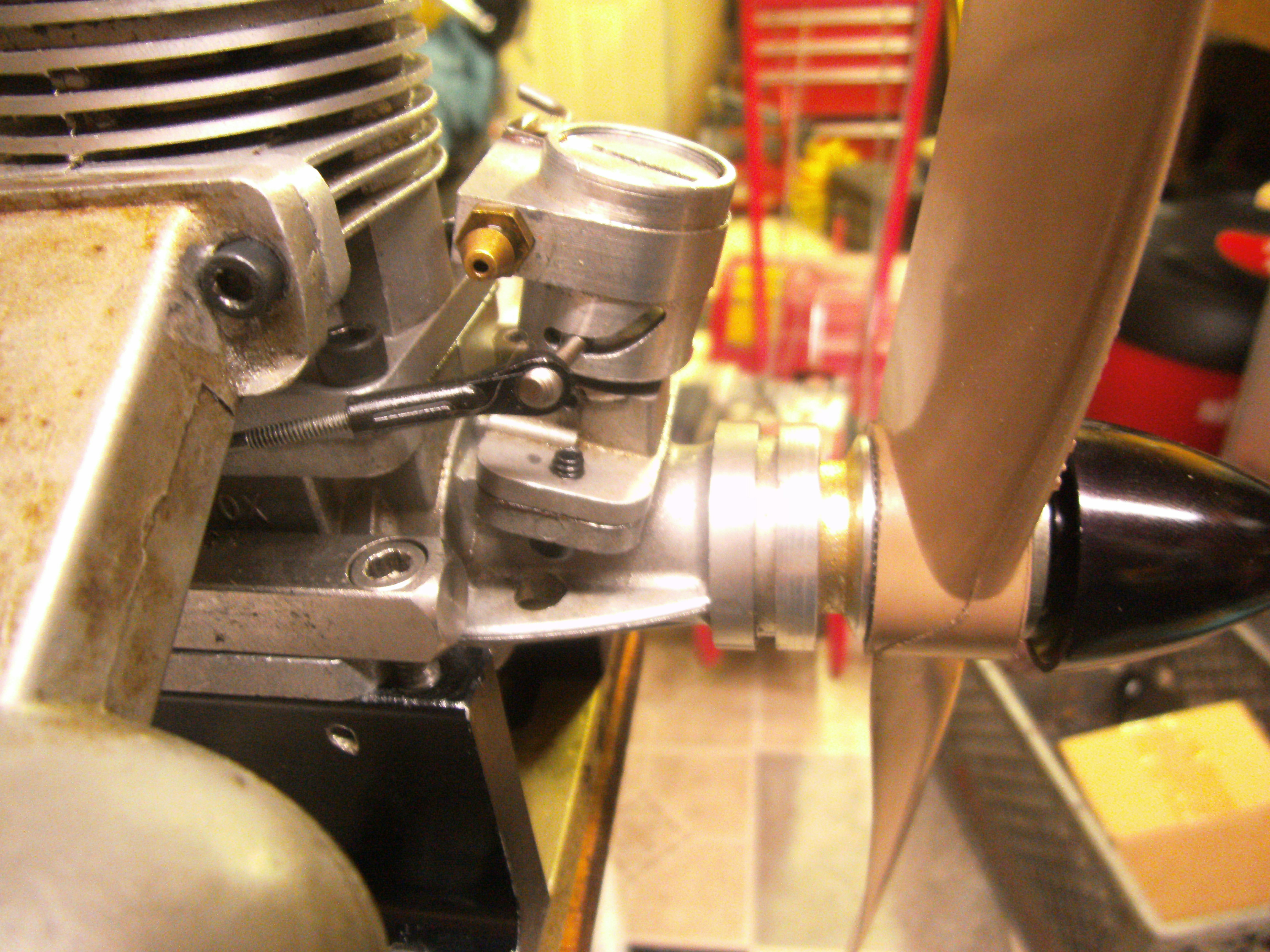

I just ran the Carb on a Fox 60 using a bolly 12.5x6, it turns the 12.5x6 about 2,000 rpm faster than the Snorer turned the 11.5x6
Fox Eagle .60 with Fox Quiet muffler
Fuel===Wildcat 10% with 18% full synthetic
Plug===Fox idle bar
Prop==Bolly Clubman 12.5x6
Max rpm with the carb===11,350
Max rpm with Fox EZ Just =11,340
Both carburetors were smooth and burble free with clean mid ranges, sub 2,000 rpm idle was easy to attain with both.
All in all it's a good carb, now I have to send it back and break in a new OS .62V,

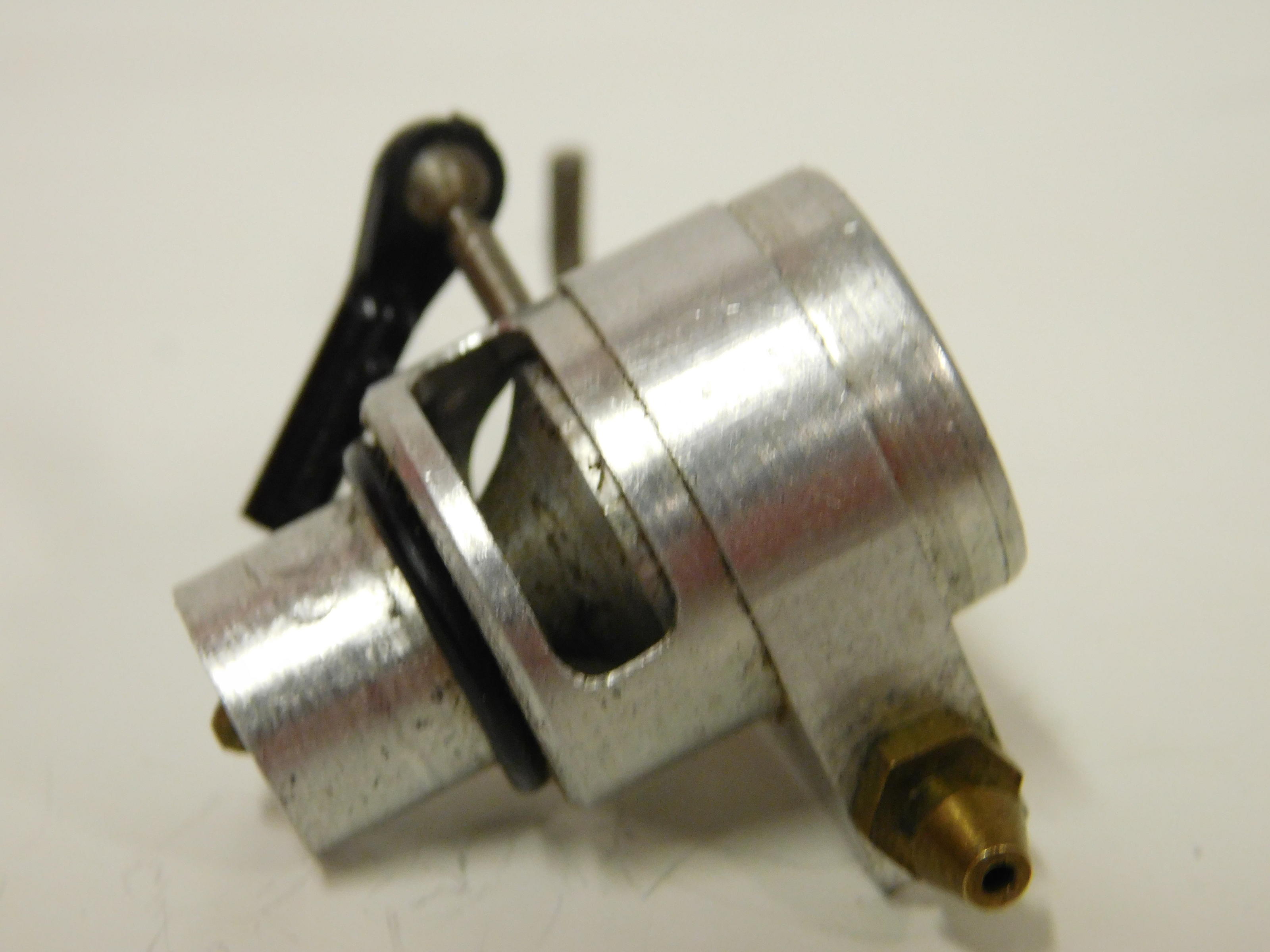

Hobbsy, ever try a Heli Carb on a plane engine ??
another question here, well I don't wish to sound stupid here, but I guess I will have to, this Carb in your photos, it's kind-of hard to see, but is that Slot on the top. is that all there is to allow air into the engine ??
Jim
Old 08-06-2017 | 02:24 AM
Hobbsy's Avatar
My Feedback: (102)
Posts: 20,370
Received 30 Likes on 28 Posts
From: Colonial Beach, VA
I'll provide a better picture, the whole left side of the carb is open in the front/left, the slot you see is a screw driver slot, that big disc is the midrange adustment. It's really simple.

If the air comes in the front, how does the fuel get from the main needle? I assumed the air came in the front and then past the main needle and that more fuel comes in somewhere else for midrange and idle.
Old 08-09-2017 | 10:37 AM
Hobbsy's Avatar
My Feedback: (102)
Posts: 20,370
Thanks Hugh, the fuel flows into the air stream from a slot in the post you see protruding from the lower end. The plunger exposes more and less of the slot as it moves up and down. The threaded cap is screwed up or down to adjust the mid range.
