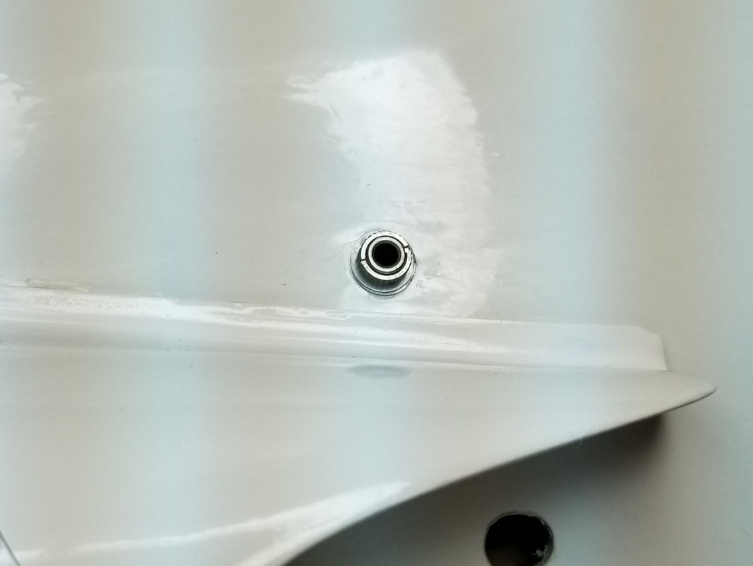

Hello everyone. I have a question. I just got a sundowner that has a remote ignitor on it. Could anyone tell or show me what I need to use this? Thanks0

You will need a battery attached to a short cable with a phone plug to plug into the jack on the fuselage.
Battery voltage shouldn't exceed 1.5 for the glow plug to last.
