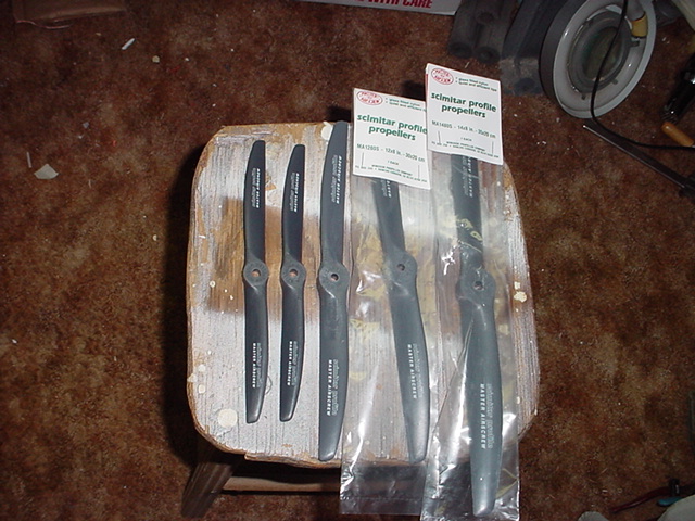

I'm a bit old fashioned, I guess....and prefer the conventional
style props. I've been using MAS since they first came out,
as well as Top Flight "Power Point's", and Zinger wood props.
I just got some of the scimitar type props today from Tower,
just to give them a try...10-7, 10-8, 11-8, 12-8, and 14-8.
I tend to use smaller props than most....with the most
pitch the engine will pull, and I think that my elevation at
3,000 ft., and the dry desert air....makes things a bit different.
For instance....I run 12-9's on .90 four strokes. Some of
the guys are using 14, and 16" props. The 12-9's don't
even unload fully in the air. (thin as it is) Another example,
I use 14-8 on an OS 1.08 FSR.....which probably makes
twice the power of a .90 4-stroke....YS's excepted....
some guys run 16 and 18" props on them.
So, don't ask me....I prefer the conventional type props....
I've used the APC's as well....and haven't found any advantage
with them.
