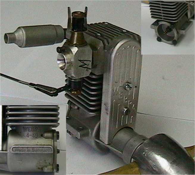

I received a used WEBRA 4-40 engine and I'm trying to put it into operation. As far as I don't have any information about the setup of the carburator, I'm want to ask for help here. Do you know the correct setup of the nozzle needles? What is reason for the rear outlet (look at the foto)? The Webra engines have a rotary valve system, is it necesary to check the system for tolerances, and what are these tolerances?
The engines turns smoothly without any major resistance or noise.
I'm looking forward to get some answers.

The rear outlet is simply a crankcase vent, put about three inches of fuel tubing on it and let it hang to vent and drain excess oil oil from the crankcase.

There is no reason to check tolerances. Even if you were to do this, there's no way to adjust them.

The Webra has an aspin valve induction and exhaust system. The main advantage and reason they were built this way is that you dont have to check for tolerances as they have no pushrods or rocker arms or tappets.

Take the front cover off and look at the belt. With any luck you'll see some timing marks on the cam wheels and the cylinder check these line up. Horizon Hobby has spare belts for these engines and probably most other parts too.

I ran one of these several years ago using 10% nitro 20% castor oil. I used a 11x6 prop (11x4 is to small and so is 10x6).
Nipple at the rear is for ventilation of the crankcase.
Timingmarks should be found inside if you remove the front cover.
Power is a little less than the first OS FS .40 from the early eighties.
