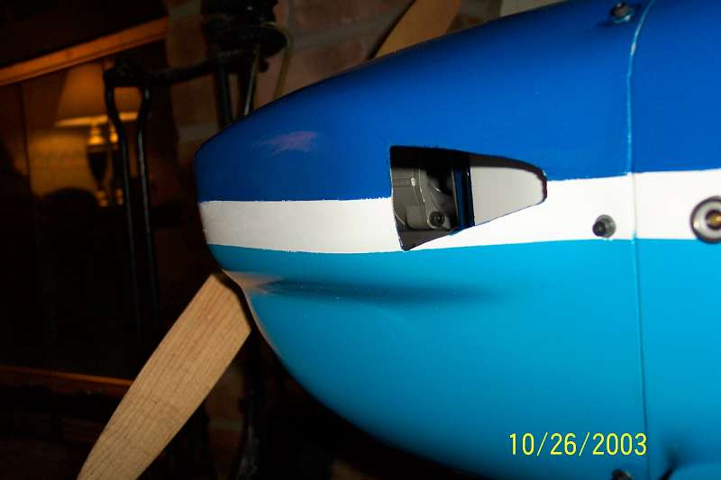

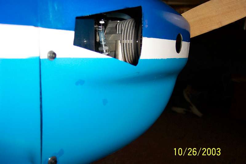

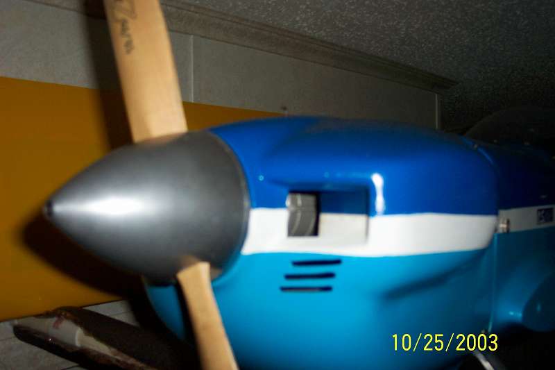

on the last few flights I noticed a pre detonating condition on my OS 1.6 in a CAP 232.
10% Powermaster fuel w/ additional 3 oz. of KLOTZ per Gal., OS # 8 plug, Zinger 18x6 Pro, Brisson Pitts Muffler, Altitude 1200'. ( Note: no pump or other fuel delivery device).
Also noticed lots of oil on Bottom of fuse, whats the cure?

thanks, I'll try open up the cowl some.This engine is totally enclosed with only the normal air intakes open plus some additional vents. also I installed a baffle to divert outside air over the cyl. head. I'm running rich now so opening up is not good.

I run the same engine in a Sig Extra 300. My Extra cowling may have a little more inlet area than yours, but not by much. The cowling exit area may be something to look at. You need 2 to 3 times the exit area to allow for effective cooling, from what I have read, and from my experience.

Hi!
The pictures you show is in any way unusual and should not make the engine run hot...I have approximately the same size openings in my SIG CAP 231 EX powerred by a MVVS 25cc ABC (1.50) and I use 15% Motul "Micro"allsyntetic oil and 5% nitro, prop is a 18x6 Menz...and this engine has never quit for me during 3 years of flying.
Fueltubing is normal size (inner diameter 1,5-2mm). It is my experience from 30 years of flying that fueltubing size has no effect on engine behavior.
I still think you run your engine too lean.

Your inlet and outlet cooling looks perfectly normal to me. Lots of theses engines end up in airplanes exactly like yours. I have been doing a lot of research on the 1.60 since I bought one (not yet ran). It seems that detonation is not too uncommon. If you're sure you don't have a fuel starvation problem leading to lean running, you could try to lower the compression by adding head gaskets.

Actually, first try the engine on a test stand or without the cowl. If you don't have the detonation problem, then you can be sure the engine's not getting the cooling it needs.
With ANY air-cooled engine, you have to make sure that the cooling air passes through the fins on the cylinder and head. Take a look at a full-size aircraft engine. No air going into the cowl is allowed to leave before it passes throught he fins of the engine. Baffling is used to direct the air where it needs to go. Take a look at some of the high performance homebuilt aircraft. A 180 Hp engine is cooled with two 3"x6" inlets. They can be that small because all the air going in passes through the cylinder fins.
In your model, you may have to build baffling to make sure that the air going into the cowl actually passes through the engine's cooling fins. If you can look into the air inlet and see the air outlet, then you can be sure that the air is taking the path of least resistance, and going directly from the inlet to the outlet, do not pass engine, do not collect cooling.
