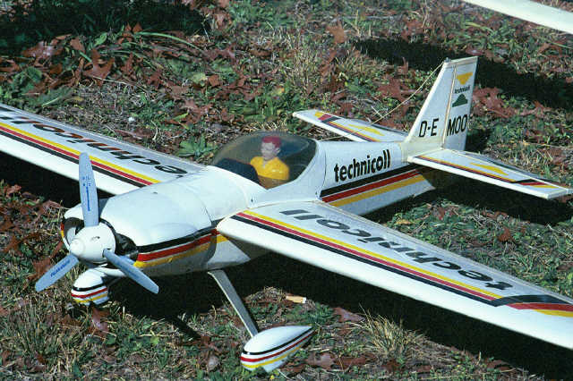

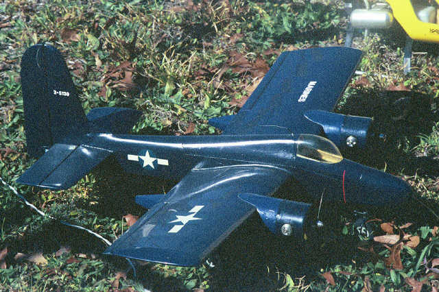

tks1:
The blue and white plane has Magnum XL 46 engines, Zinger 10x8 props. The little dark blue twin has Cox props on the AMD 0.061 engines. The big single has a Graupner 12x8 on a K&B 61.
They all fly well with their 3-blade props.
Bill.
