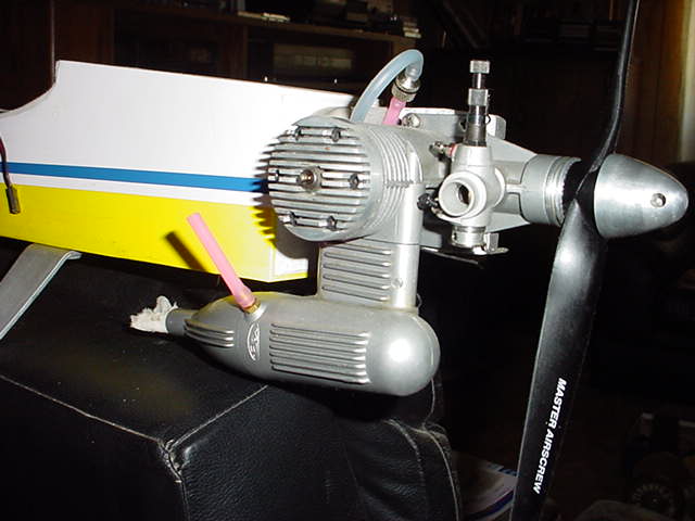

I'm looking for what would be the best two-stroke engine in my Aresti 40. I'm looking for speed but also pretty good throttle response. I have looked at the Thunder Tiger 61 and also the OS 91 FX. Would the 91 be way to much power. I need that proper balance of power vs weight. Please let me know what your thoughts are.

Having already made the mistake of grossly overpowering my Arresti, I
can say....don't get too carried away looking for too much speed. They
are suceptable to flutter at high speed....mine almost blew apart. If it
were not for the duel elevators....mine would be toast....[X(]....I have
it fixed, and pretty well sorted out now....
....if I were to do another one, I would put either the YS .63 four stroke,
or my favorite .46 replacement motor....a re-carbed K&B .61 in it.
Dave.
