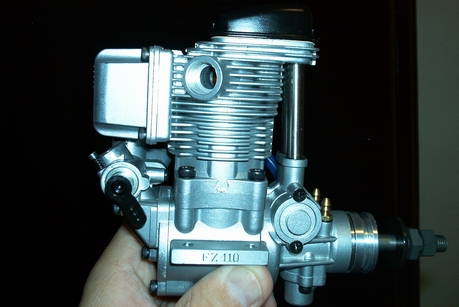

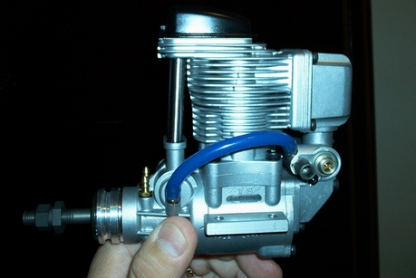

My pride and joy engine pics are below:
Dennis
