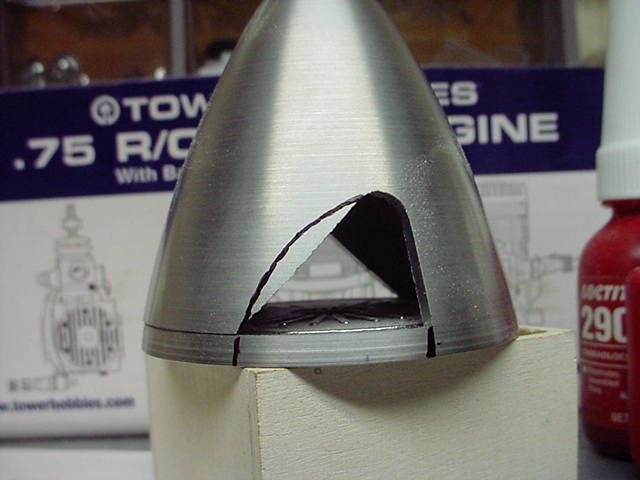

Most aluminum spinners have to be modified to use on the
larger engines. It is not hard to do. I use the 1" belt sander.
They will cut almost as fast as hard-wood. You will of course,
have to rebalance the spinner cone after you open it up.
Dave.

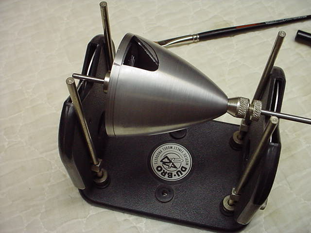

How do you balance the cone?

Use a dubro or a top flight magnetic balancer. Those things are great. I take a dremel tool and grind out a small bit on the heavy side until it balances out. Do this on the inside of the spinner so you don't destroy the appearance of the spinner.

On balancing a spinner - it's important to balance the backplate by itself first, since you will never be putting the cone and plate together in exactly the same position. After the backplate is balanced, put the cone on and balamce the assembly, and this time cut material from the cone ONLY to correct any imbalance.
