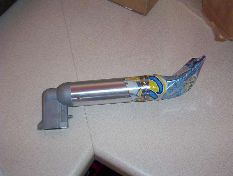

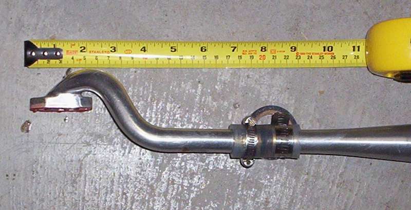

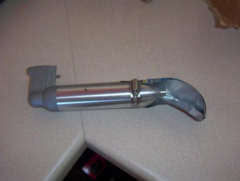

The 1160 is a non muffled pipe, so noise is a issue.. the 1062 long stroke pipes baffle is further back. The 1090 is longer and more money.. both work well... The headre is a Karl Mueller header which is very well made header and is the only i will use... If you need one I may have access to one at $47.00 plus shipping. Let me know..This engine is a power house and people are coming back around to two stroke for pattern.. I think if OS made this a pumped engine it would be a kick butt setup..
I uploaded a picture of the header for you..
Scott
Scott

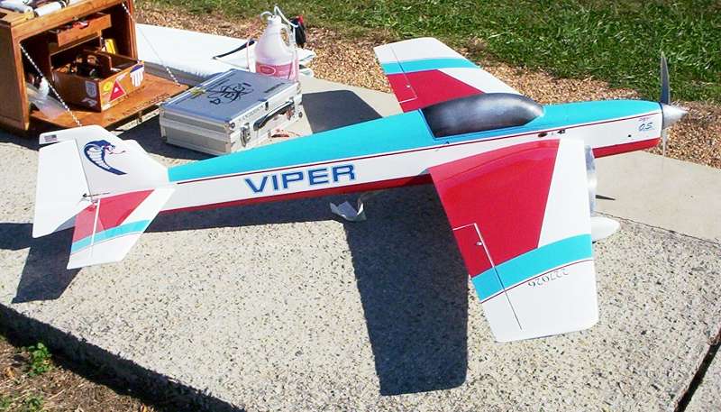

Obolel,
We have found that it last longer and holds up to the Nitro better, I have tried the OS number 8 I think it was ( the plug that they reccomend ? ) and I had proplems with it, In the early stages of setting up the engine I did have the Iron bay models fuel regulatior in place for the first 18 flight during testing and we would go thru a plug about evert 2 flights , then the night before the contest we where showing this at, almost lost the plane from the regulator, in a mad scramble we went to basics and the first round of the contest was also a test flight.. The set up is: OS91 fx with a KM header and macs 1062 pipe with 25% nitro and OS F plug and and a 15x10 or 14x10 APC prop, fuel tank is on the CG and ONLY pipe pressure and NO head shims for me.. Also I have use some other plugs since and I just keep going back to the OS F plug.
The photo is Viper OS project 1 and 2. Mine is OS Viper # 1 ( red/white/blue)
scott
scott
